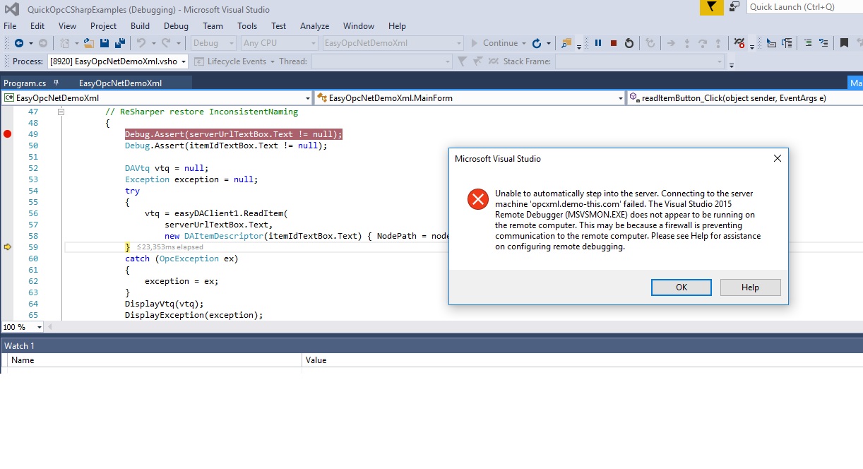

26 Sep 2016 08:55 #4379 by support
I what you are trying to do, the COM component is our QuickOPC product. COM is just used between your code, and QuickOPC. QuickOPC then connect to a Web service, that is an OPC XML-DA server.
I do not understand what are you trying to do with remote debugging. You should simply debug locally. And, we are not that much interested in what happens *inside* the ReadItem method itself - we just need to know the details of the exception it throws.
And, I do not understand why - at least according to the picture - you have now switched to debugging the C# demo - you have said that (as opposed to your app) it works well, so why debug it?

26 Sep 2016 07:46 #4378 by Vasanth
Hi Team,
When I am trying to debug OPC XML DA Csharp application I am getting a remote debugging error, Am I able to enter into easyDAClient1.ReadItem(serverUrlTextBox.Text,new DAItemDescriptor(itemIdTextBox.Text{ NodePath = nodePathTextBox.Text })) this function via remote debugging? Please refer attached image.
As I understand, XML DA client should connect to Webservice to get the data. In our sample code we still use COM components to connect to XML server(reusing OPC DA connection)? How this connection is happening to XML server? COM should not come into the picture right? or this COM component used only to connect XML server?
Please correct my understanding if I am wrong.

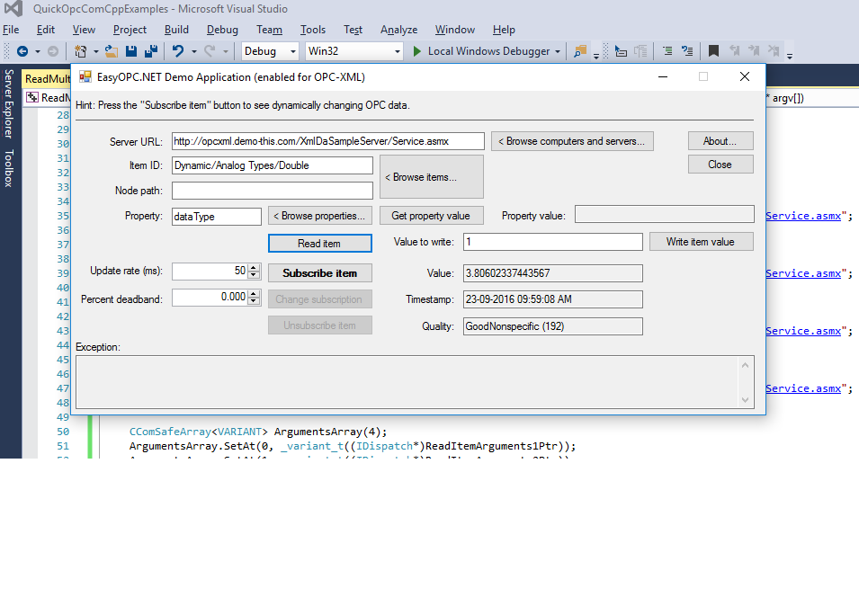

23 Sep 2016 10:17 #4375 by support
Thank you. It is weird - the code accesses the same server, and even the first item is the same as in the demo app, therefore it should work.
The only thing that can bring us closer is examining the exception details (Message, possibly InnerException, etc.). Can you change the code for that, or do you need help with it?

23 Sep 2016 10:08 #4374 by Vasanth
The OPC XML-DA enabled demo application can read data from XML server, I guess there is no issue with firewall settings. Refer attached image.
As of now I am trying with demo server which OPClabs providing, I can handle exception when I write production code. But, My doubt is that, this code could not fetch the values from demo server, as demo application can fetch. Is it kind of any logical issue or syntax based.
Please help.
