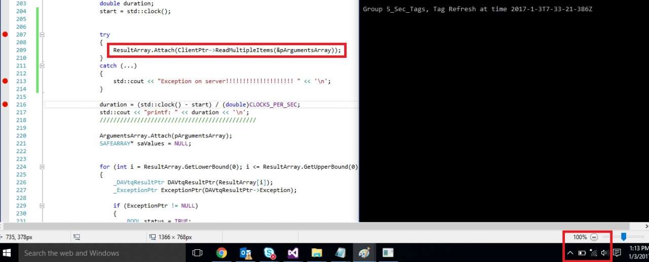

03 Jan 2017 07:59 - 03 Jan 2017 08:13 #4735 by Vasanth
In .net based demo application its not reproduced since the below exception is handled, and its showing exception "The Operation has timed out"
, please refer .net based demo app threads and callstack.
In case of C++ application no exception is handled, after entering into ReadMultipleItems(&pArgumentsArray) function I am disconnecting internet and it keep hangs there only. refer attached image.
And I also created threads n callstacks for my c++ application, I feel this one is having manged threads.
Please check it and let me know if you need any other info.
