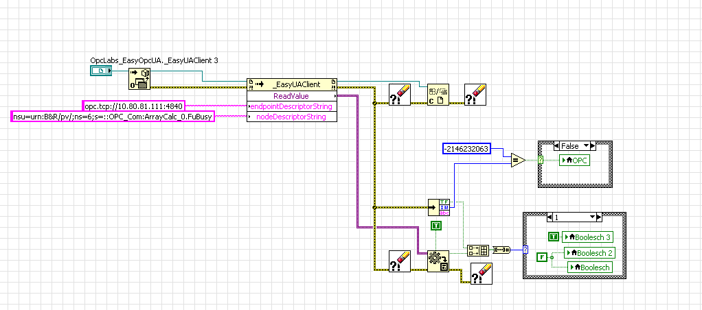

we´re using EASYOPCUA with Labview (COM) to connect to a motorcontrol.
We want to read the value of the variable "FuBusy" every second. (attached picture)
Until now everything works fine.
The problem is that the read function gets stuck and also blocks Labview if we disconnect the client from the server and it doesn´t seem to react any more.
Which timeout do we need to reconfigure to solve this problem?
Or are there any other settings that have to be changed?
With kind regards,
Felix Zeis
With kind regards,
Felix Zeis

we´re using EASYOPCUA in Labview to connect to a motorcontrol.
We want to read the value of the variable "FuBusy" each second. (Attached picture)
The main problem is that the read function gets stuck as soon as we disconnect the client from the server and doesn´t seem to react any more.
We want it to keep trying to read the value and to return an error if the client is disconnected.
So my question is which timeouts do we need to reconfigure to avoid this problem?
Or are there any other settings that have to be changed to solve this problem?
