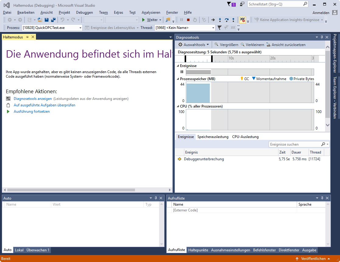

28 Nov 2016 15:37 #4602 by RH
The call stack windows is displayed, but it says something like "The app has been stopped, but there is no code to display because all threads run external code (system or framework code)". I only have a screenshot in german language, but that's how it looks like:
Do I need to add some files to the search path or something? I just installed it without setting anything...
28 Nov 2016 14:49 #4601 by support
In my Visual Studio (which is not a Community), I can use "Debug -> Windows -> Call stack" command from the menu. Do you have that in your VS?
Source code should not be necessary for this, as in the call stack we need just the methods names, and they are already in .NET assembly metadata.
