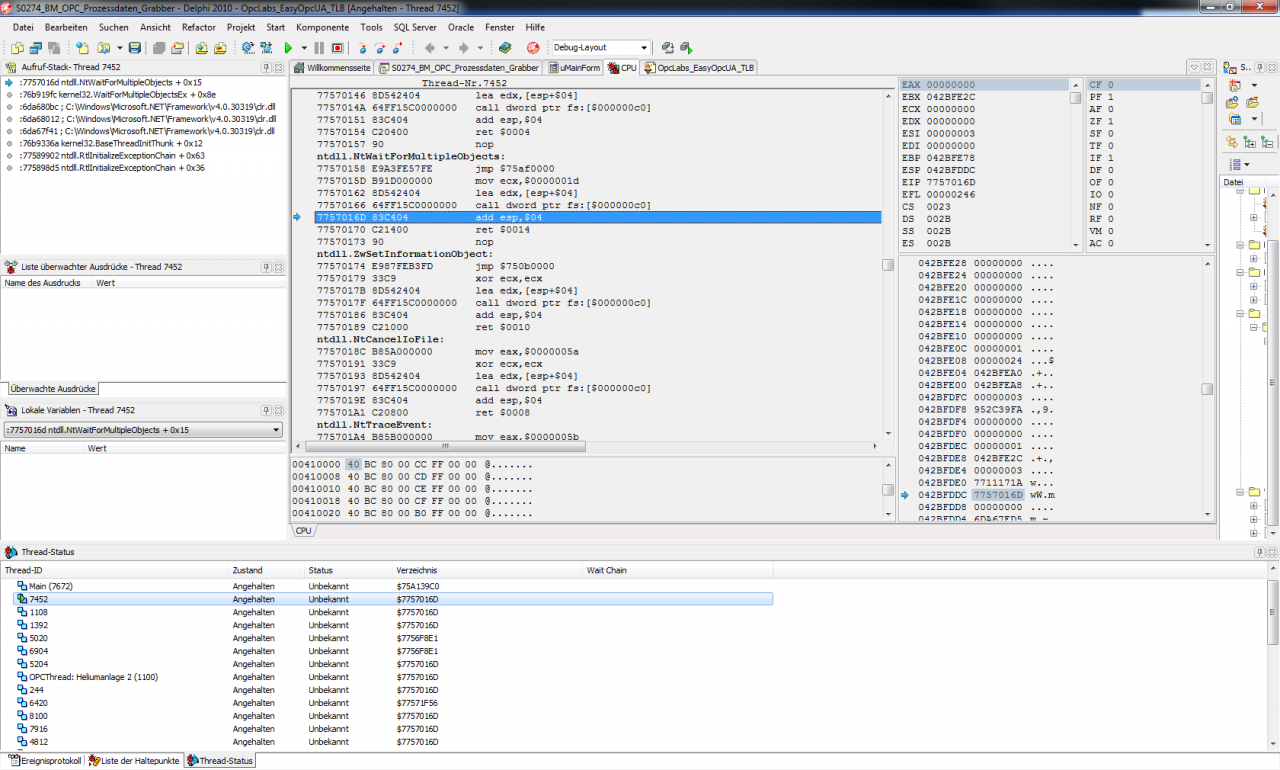

thank you for your support. I really would like to provide some callstacks, but as I use the COM version from my Delphi program, the stacks are not very readable, except for my own code.
Most other threads belong to the ntdll and clr.dll, when I take a look into it in the "process explorer". In my Delphi IDE, I can only identify your threads, because the stack refers to .NET framework:
And as I assumed before, some WaitForMultipleObjects statement is waiting for something to happen which does not. There is one more thread which refers to the .NET framework which has a WaitForSingleObject on top of the callstack. I don't know if that could help you any further?
