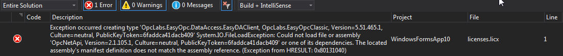

08 Jan 2018 15:05 #5828 by bobday
Never mind. I figured it out..
08 Jan 2018 14:58 #5827 by bobday
How do I do that?
08 Jan 2018 14:43 #5826 by support
It looks like that I have not explained clearly what I meant. I think that you have physically deleted the file, but it is still listed in the Visual Studio project. What I meant was to delete it from the project (which should also deleted it from the disk).
08 Jan 2018 14:38 #5825 by bobday
I deleted the .licx file and tried to re-Build. Now I get an error "Could not find file 'F:\Machinery Software\VisualStudio\WindowsFormsApp1\WindowsFormsApp1\Properties\licenses.licx'.
08 Jan 2018 06:59 #5816 by support
can you please delete the licenses.licx file mentioned in the error and re-test?
05 Jan 2018 22:34 #5814 by bobday
see attachment...
