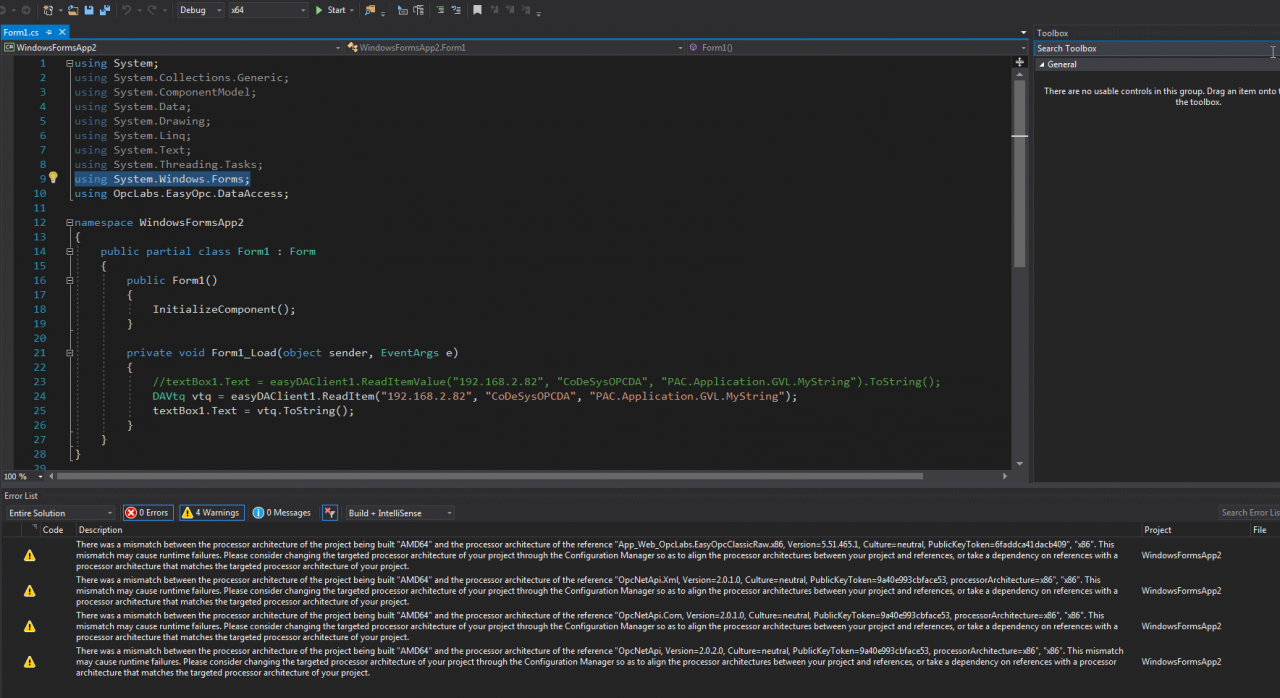

The warnings should be benign and not related to the other issue. They probably appear because you have referenced more assemblies than needed: For this kind of project, you should be fine referencing just OpcLabs.BaseLib and OpcLabs.EasyOpcClassic and nothing else. See opclabs.doc-that.com/files/onlinedocs/QuickOpc/Latest/User%2...%20Assemblies%20Available.html , opclabs.doc-that.com/files/onlinedocs/QuickOpc/Latest/User%2...%20Assembly%20Referencing.html , opclabs.doc-that.com/files/onlinedocs/QuickOpc/Latest/User%2...Visual%20Studio%20Toolbox.html . As far as I can tell, you have even referenced assemblies that have nothing to do with our product. We have similar assemblies, but not of that version and processor architecture that is listed in the warning. You should remove the unnecessary assemblies from the project references.

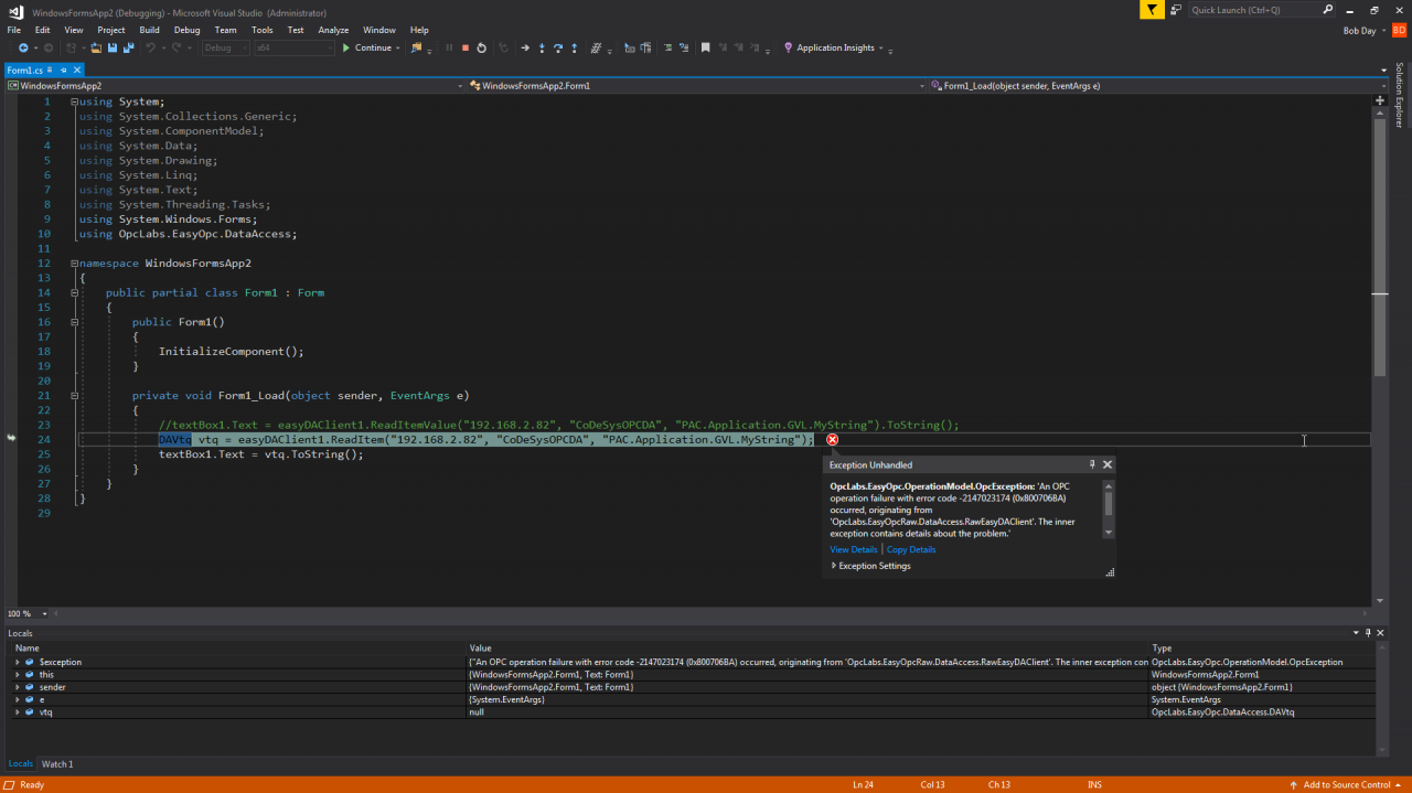

To the actual issue: The method has thrown an exception, that is not called a hung. Exceptions are how the ReadItem or ReadItemValue signalizes errors, so in some respect that are normal and should be expected. A production-ready code should have a try-catch block around these methods, and catch exception of type 'OpcException'. See e.g. opclabs.doc-that.com/files/onlinedocs/QuickOpc/Latest/User%2...eption%20or%20UAException.html .
The exception tells you that the details are in its InnerException, so that's what should be inspected, but I can tell from the error code (0x800706ba) that the innner exception says "The RPC server is unavailable.". This is an error that comes from the DCOM infrastructure (Microsoft), which is what OPC Classic uses for inter-machine communication. There can be many causes for this error, but first things to check are 1) whether the IP address is correct, 2) whether DCOM is enabled on the target computer, 3) whether the firewall on the server (or client) computer does not block DCOM communication (this is not a single port, but a port + a range of ports), 4) whether OPCEnum service is running on the server computer. See e.g. www.opclabs.com/resources/technology-opc/opc-videos/opc-dcom . The screenshots from Connectivity Explorer appear to be ran on the same computer as where the server is, so that may work, but a comparable test to what your code does would be to run the Connectivity Explorer on the computer where your run you code-based test, select the "Any COmputer" node and then add a computer node with the same IP address.
10 Jan 2018 03:05 #5849 by bobday
Tried x86, x64 and all, but still had errors.
I then ran program with break point on first line, but program hung on that line.
