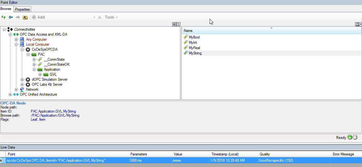

Connectivity Explorer shows the correct value for the Item. see attachment
I used the same 3 parameters for easyDAClient1.ReadItem() as I did for easyDAClient1.ReadItemValue(), hope this is correct.
Still had an empty textbox when the app ran.

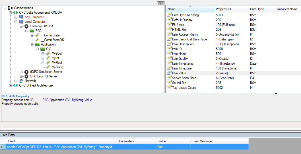

Regarding the picture from the Connectivity Explorer: In that picture, you are not actually displaying the value of the item. You are displaying the "Item Value" property of the item, which is a different thing. I know it might be confusing, but it is simply so. OPC Properties are not meant to be used for efficient access, and in fact they may not work like this with many servers, unless you are actually using the same item in the regular way.
So what you are showing in the Connectivity Explorer is different from what the code snippet does.
In order to do the same as the code in the Connectivity Explorer, you need to click on the "GVL" node in the left pane (the tree), and the select the "MyString" from the list in the right pane.

09 Jan 2018 16:17 #5836 by bobday
My client on my computer located on the same network as the Parker PAC controller. I used the Connectivity Explorer (see attachment) to confirm naming of vars.
This code still dosen't work:
textBox1.Text = easyDAClient1.ReadItemValue("192.168.2.82", "CoDeSysOPCDA", "PAC.Application.GVL.MyString").ToString();
