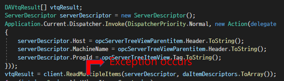

    10 Jan 2022 07:57 #10535 by yong
    OPC DA browsing error. was created by yong
    Hello
    I'd like to have some information about these below.
    - AnotherOPC Client program brings opc data.
    - However, I can't get the opc data through the opc library.
    * Other clients bring data, but I wonder if it is not possible in the opc library. Some clients have data collection, some don't and I wonder why this problem occurs.
    opc server: SchneiderElectric.SCADA.OpcDaServer.1
    IP: localhost
