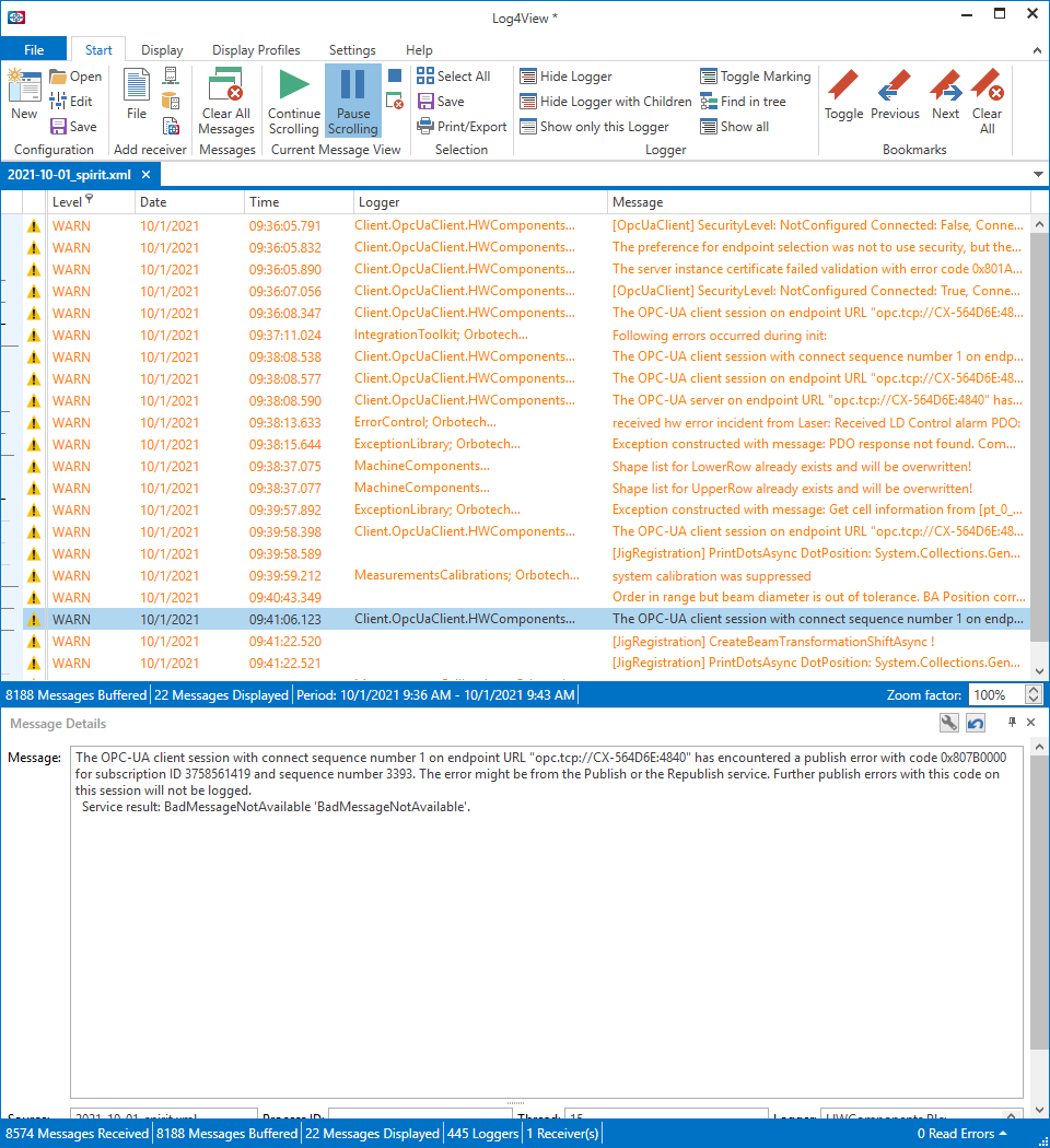

05 Oct 2021 11:56 #10252 by RoadRunner2021
In the overall context, the connection consists of 4 subscriptions and approx. 450 nodes.
The most important subscription comprises approx. 50 nodes and is operated with a (Sampling / Publish) 50ms / 50ms setting. (CommandHandling) (Time-critical)
The remaining 400 nodes or subscriptions are automatically created by the client without any specified user settings.
There, subscriptions with timings of (Sampling / Publish) 300 / x, 1000 / x etc. are created and operated.
The client (IPC) is connected to the Beckhoff PLC (CX5130-0175) via LAN (1000Mbit).
I'll send you Wireshark logs. Since these warnings / errors lead to information loss)

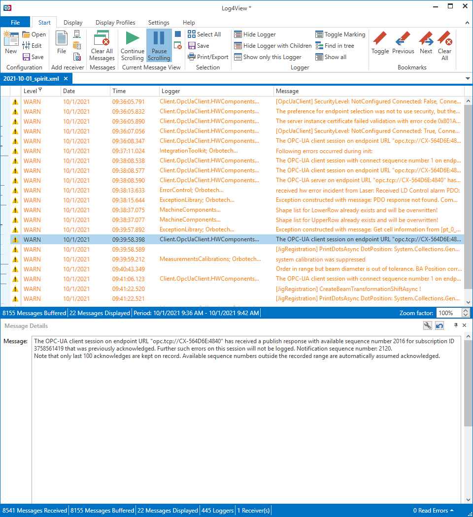

04 Oct 2021 06:41 - 04 Oct 2021 07:09 #10249 by RoadRunner2021
Hello OPC-Labs team,
we have problems with the pub / sub process and keep running into problems in tests.
The error patterns are diverse, from a subscription (request timeout) to an extremely high latency of seconds, although the specific nodes were subscribed to with very fast timings (subscriptions).
I have attached two screenshots to the topic for you, can you explain the cause of the errors?
OPC UA Server Beckhoff SPS (CX 5000 Serie)
Clientversion 5.54.1311 (C#)
Kind regards
Last edit: 04 Oct 2021 07:09 by RoadRunner2021.
