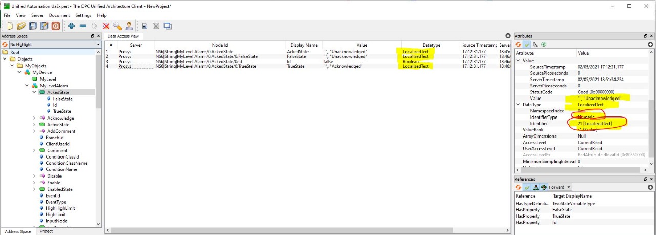

02 May 2021 17:57 #9643 by support
Yes. It is one of the built-in OPC UA types.
But QuickOPC only supports the "default" locale of any LocalizedText. So, in QuickOPC you will only see it as "String". Some other data types may also undergo a conversion.
opclabs.doc-that.com/files/onlinedocs/QuickOpc/Latest/User%2...ata%20Types%20in%20OPC-UA.html

02 May 2021 15:54 #9641 by micham
Is "LocalizedText" a valid OPC UA data type?
