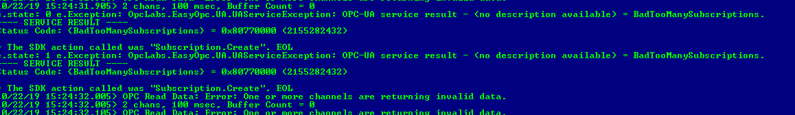

Ad 3. The reason I asked this is that the rate is primary parameter of a subscription, and QuickOPC will create a separate subscription for each rate. So, if one wants to limit the number of subscriptions, he/she should not have too many different rates.
Ad 4. The BadTooManySubscriptions error is coming from the server. The servers in PLCs are typically quite limited in number of sessions, subscriptions etc. they support, so in a way it is not such a big surprise to receive this error from an embedded server/PLC. Check your rates (point 3 above). Also, QuickOPC (as mandated by OPC specs) creates one additional subscription to those of yours - to check the status of some server variables. This is not strictly necessary, so you can turn it off, and will have one down. To do so, set the EnableStatusSubscription property to 'false' ( opclabs.doc-that.com/files/onlinedocs/QuickOpc/Latest/User%2...~EnableStatusSubscription.html ), paying attention to Remarks on that class (quote):
In order to obtain or modify these parameters, in the default state (when OpcLabs.EasyOpc.UA.EasyUAClient.Isolated equals to false), access UAClientAdaptableParameters.SessionParameters property of static OpcLabs.EasyOpc.UA.EasyUAClient.AdaptableParameters. If you have set OpcLabs.EasyOpc.UA.EasyUAClient.Isolated to true, you need to access UAClientAdaptableParameters.SessionParameters property of OpcLabs.EasyOpc.UA.EasyUAClient.IsolatedParameters.
So unless you have changed the value of EasyUAClient.Isolated to 'true', you would do something like
OpcLabs.EasyOpc.UA.EasyUAClient.AdaptableParameters.SessionParameters.EnableStatusSubscription = false;
I hope this helps

So I have some simple code to subscribe to a few channels. Has been working fine for multiple connections. And now I'm getting the error (attached in screenshot). Looks like there it has hit a limit on the number of subscriptions ... but I am always unsubscribing when I close the software. This is done in the CloseDigitizer function. Is there something else I should be doing to clear or reset the connection to avoid this error? thanks
