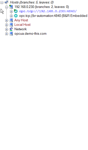

Just a small question; is there a means of giving the created node a name/placeholder. This isn't a huge deal it just might make things easier for clients
Edit: In the image the top endpoint is the one I've added, is there anyway of modifying the display name
Last edit: 07 Jul 2017 14:46 by AdamBOD.
07 Jul 2017 09:16 #5319 by support
Yes - set it to control's InputsOutputs.CurrentNodeDescriptor.EndpointDescriptor property.
The following user(s) said Thank You: AdamBOD
07 Jul 2017 09:06 #5317 by AdamBOD
Sorry, yes I mean adding endpoints. Since it's non persistent is there any way of programmatically adding an endpoint to the browsecontrol?
07 Jul 2017 08:51 #5315 by support
I do not know what you mean by "adding PLCs". Please describe the steps you are taking. Do you mean adding UA endpoints manually, using the green "+" icon?
And yes, the browse control does not persist the data to the disk or elsewhere. You should be able to do it yourself, by storing the outputs of the dialog and then feeding them back to the inputs.
