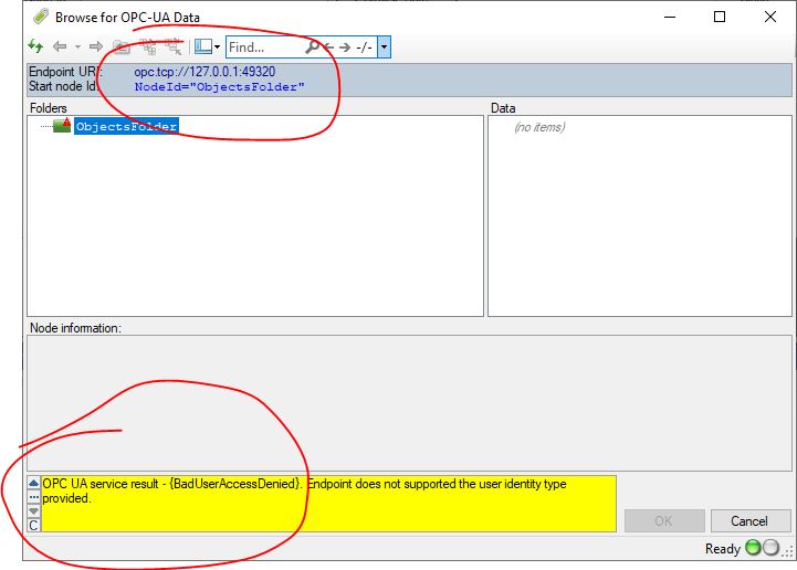

06 Jul 2021 14:45 #9902 by support
Since you did not state that you doing anything to authenticate the user, I assume that you are not doing it.
The server is probably configured to only accept authenticated users on the endpoint you have chosen. There are multiple ways in OPC UA the user authentication can be done (and it depends on the server which methods it supports), but the most common is username + password.
In the code, user name and password can be configured in the UAEndpointDescriptor, either by setting the appropriate properties, or with the .WithUserNameAndIdentity extension method (example: opclabs.doc-that.com/files/onlinedocs/QuickOpc/Latest/User%2...ind%20all%20registrations.html ).
06 Jul 2021 14:36 #9900 by micham
When I try connecting with the KepServer UA, I get the following message:
OPC UA service result - {BadUserAccessDenied}. Endpoint does not supported the user identity type provided.
Can you please let me know what is wrong with the user identity and how can I change it?
