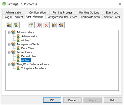

17 Jul 2021 17:02 #10006 by support
Please verify that the endpoint descriptor you are passing to the browse is actually the one you have listed below (the gdsEndpointDescriptor variable). It does not look like that this is the case, because the error message contains "+ The user identity used was: Anonymous.". If you were passing in the right endpoint descriptor, it would have "Anonymous", but also with added something like ", UserName("micham", **).
BTW, please edit your previous post and remove your password in case it is something you do not want the world to see.
17 Jul 2021 14:46 - 18 Jul 2021 06:27 #10005 by micham
I am using this code in my OPC client.
Dim gdsEndpointDescriptor As UAEndpointDescriptor =
New UAEndpointDescriptor(MyServerURL) _
.WithUserNameIdentity("micham", "**************")
I have defined a user in the KepWare OPC UA server (see attached)
I have set "Allow Anonymous Login" to "No".
I tried browsing and got the following error. Any idea what is the problem?

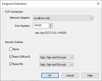

a) Additional question: Which checkboxes do you have enabled under "Security Policies" in the Endpoint Configuration for the endpoint you are using, in the KEPServerEx? I am referring to the dialog (example) below:
b) The "appuser" username and "demo" password are for the GDS example server. I am not sure if you have configured your server to use the very same user name and password.
