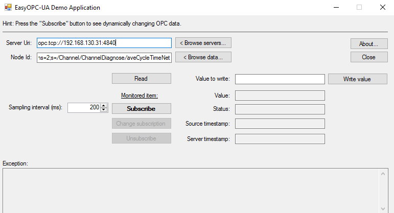

Let me try to rephrase the problem from the start and to explain the larger goal: I am trying to read the values of some variables on an OPC UA server hosted by a Siemens Sinumerik.
This is something I have already accomplished with a previous server (which had no authentication) and I used the sample "EasyOpcUaDemo" to verify the variables node id and value correctness during the process (as I'm doing this time).
With the previous server and the unmodified sample "EasyOpcUaDemo" I was able to browse each and every variable contained and read their values.
With the current server I don't see any branch or leaf when browsing its content (as shown in the attachment of the first post).

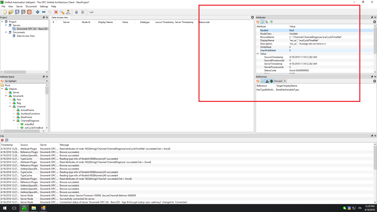

2) In your original post, you wrote "values on it can be viewed using the application “UaExpert DataAccess View” even though their NodeId is apparently null.". Can you please send a screenshot of this, because I find it hard to believe.
This is a screenshot of UaExpert showing that even though the NodeId is null, its Value is readable.
(I know it's barely readable under "StatusCode", but right now I'm not able to provide a better one)

Basically, as shown in the previous screenshot, the UaExpert displays an attribute named "BrowseName"; I have converted that one (2, /Channel/ChannelDiagnose/aveCycleTimeNet in the picture) to a "NodeId format" (nsu=SinumerikVarProvider;ns=2;s=/Channel/ChannelDiagnose/aveCycleTimeNet) and pasted it into the sample EasyOpcUADemo to which I've only added these lines of code:
this.easyUAClient1.Isolated = true; this.easyUAClient1.IsolatedParameters.SessionParameters.UserIdentity.UserNameTokenInfo.UserName = "myUsername"; this.easyUAClient1.IsolatedParameters.SessionParameters.UserIdentity.UserNameTokenInfo.Password = "myPassword";
This is how I am able to read even if the NodeId is null.

Right now, on UaExpert - under the Attribute tab, I can see that the NodeId is null;
If I use the modified sample of the EasyOpcUaDemo and read on the NodeId nsu=SinumerikVarProvider;ns=2;s=/Channel/GeometricAxis/actProgPos[u1,5], the server responds with a BadNodeInvalidId;
If I check on UaExpert the variable's BrowseName, convert it to a NodeId (nsu=SinumerikVarProvider;ns=2;s=/Channel/GeometricAxis/actProgPos) format and use the modified sample of the EasyOpcUaDemo to read its value, I get a correct reading;
