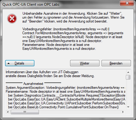

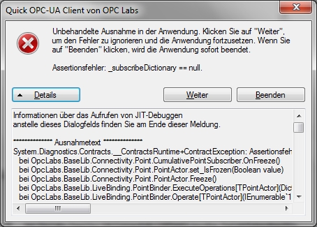

If I execute the compiled application (out of Visual studio), then I get the exceptions 01 (see Exception01.jpg) right after start and the exception 02 (see Exception02.jpg) by closing the application.

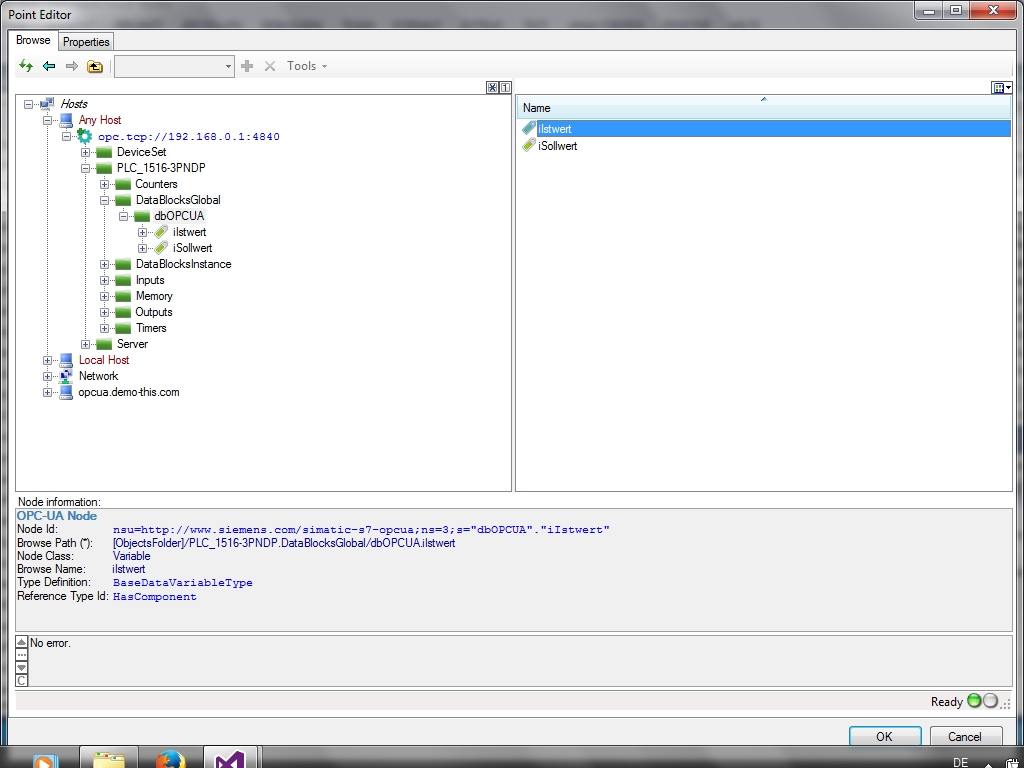

06 Mar 2017 10:07 #4989 by rhoerner
OK, now I did die proper way and OPCLabs find the UA-Server and I can browse the nodes and choose one node to connect it with a textbox.
But if I start the application, the application throws a untreated exception in the overridden method components.Dispose() of Forms1.Designer.cs.
The exception is of type OpcLabs.BaseLib.dll and the additional information which I get is calles "Assertionerror _subscribeDictionary==null".
If I execute the compiled application (out of Visual studio), then I get 2 exceptions:
1. monitoredItemArgumentsArray==null
2. "Assertionerror _subscribeDictionary==null"
Whats the problem?

I tried to play with the Point Editor in a similar situation you described (when browsing for servers does not work), and entering the server manually. And, I have realized one case in which I can get precisely the same error as you.
The *proper* way to enter a server URL, if you cannot browse for it, is to 1. select the "Any Host" node, and then insert a node with the URL (such as "opc.tcp://192.168.0.1:4840") of your server (in the dialog, this is denoted as inserting "OPC-UA Endpoint Node". This works for me.
The *improper* way to do this is to try to insert a "Host" node. For example, if you select the root node ("Hosts"), and then manually insert a node and type in "opc.tcp://192.168.0.1:4840", you will end up with "host" node that has a name of "opc.tcp://192.168.0.1:4840". That's not right (the host name should be just "192.168.0.1", in this case). If I do this improper procedure, I end up with precisely the same error as you (The requested name is valid, but no data of the requested type was found).
Can you verify whether you have not made this mistake, buy repeating the procedure from the start, in the proper way?
