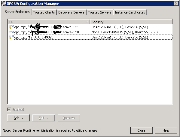

07 Jun 2016 19:05 #4110 by giles
Replied by giles on topic How to trust the server
However - when I also disabled the 49320 ie the open one endpoint it seems to work! That's odd.
I'm goiung to go home now but I think it will be ok
thanks a lot - will post tomorrow to let you know...

07 Jun 2016 18:57 #4108 by support
Replied by support on topic How to trust the server
The 49321 is for us just a discovery endpoint. If the server then lists all its endpoints during discovery, we can end up picking a different endpoint for the actual communication.
07 Jun 2016 18:55 #4107 by support
The hosts, as indicated in the endpoint addresses, must be accessible from the client side. This can be a problem with the endpoint that uses 127.0.0.1, because when this address is passed to the client and the client decides to use this endpoint, it would address its own machine, and not the server's. Please try to disable or remove this endpoint.

07 Jun 2016 18:52 #4105 by giles
here you go... (scrubbed the names out)
07 Jun 2016 18:45 #4104 by support
This has pointed me to something.
Can you send me an image, or a precise copy of information, that you have on the "Server Endpoints" tab in the "OPC UA Configuration Manager" of the Kepware server?
