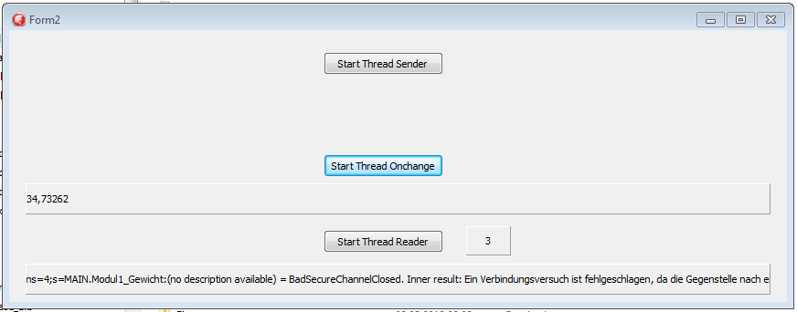

12 Mar 2018 14:41 - 12 Mar 2018 14:57 #6133 by RVersteeg
Hello !
I have a simple application with two threads !
One Thread read a Value Weight from a TWINCAT 3 OPC Server !
procedure TOPCThreadReader.Read; VAR Arguments: OleVariant; Results: OleVariant; WriteResult: _ValueResult; res: string; i: integer; Value : Variant; begin ReadArguments.EndpointDescriptor.UrlString := 'opc.tcp://920-11-01-003:4840'; changer := false; ReadArguments.NodeDescriptor.NodeId.ExpandedText := 'ns=4;s=MAIN.Modul1_Gewicht'; Position_Read:=1; Arguments := VarArrayCreate([0, 0], varVariant); Arguments[0] := ReadArguments; Position_Read:=2; TVarData(Results).VType := vararray or varVariant; Position_Read:=3; TVarData(Results).VArray := PVarArray(Client.readmultiplevalues(PSafeArray(TVarData(Arguments) .VArray))); Position_Read:=4; for i := VarArrayLowBound(Results, 1) to VarArrayHighBound(Results, 1) do begin WriteResult := IInterface(Results[i]) as _ValueResult; if WriteResult.Succeeded then begin Value:=WriteResult.value; Rueckgabe:=formatfloat('0.000',value); Position_Read:=5; end else begin res := ReadArguments.NodeDescriptor.NodeId.ExpandedText + ':' + WriteResult.Exception.GetBaseException.Message; Rueckgabe:=res; Position_Read:=6; end; end; Varclear(Arguments); end;
The Second Thread "TOPCThreadChange" has a Client with one Monitored Item Weight
procedure TOPCThreadChange.subscribe; var i: integer; Arguments: OleVariant; // Handle: Cardinal; HandleArray: OleVariant; MonitoredItemArguments: array of _EasyUAMonitoredItemArguments; laenge: integer; Position: integer; begin try laenge:=1; MonitoringParameters := CoUAMonitoringParameters.Create; MonitoringParameters.SamplingInterval := 100; setlength(MonitoredItemArguments, laenge); for i := 0 to laenge - 1 do begin MonitoredItemArguments[i] := CoEasyUAMonitoredItemArguments.Create; MonitoredItemArguments[i].EndpointDescriptor.UrlString := 'opc.tcp://920-11-01-003:4840'; MonitoredItemArguments[i].NodeDescriptor.NodeId.ExpandedText := 'ns=4;s=MAIN.Modul1_Gewicht'; MonitoredItemArguments[i].MonitoringParameters := MonitoringParameters; end; Arguments := VarArrayCreate([0, laenge - 1], varVariant); for i := 0 to laenge - 1 do begin Arguments[i] := MonitoredItemArguments[i]; end; TVarData(HandleArray).VType := vararray or varVariant; TVarData(HandleArray).VArray := PVarArray(Client.SubscribeMultipleMonitoredItems (PSafeArray(TVarData(Arguments).VArray))); except end; end;
The Application connect over Network to the TWINCAT 3 OPC UA Server !
1. Now I Disconnect the network cable.
2. Wait Until a Error Message Appears.
3. Connect Network cable.
4. Wait Until Weight Value Appears. O.K.
After 5 to 10 retrys i got an Error . EBadSecureChannelClosed !
The Client never connect again to the OPC UA Server !
I have a Trace the scenario !
Last edit: 12 Mar 2018 14:57 by support.
