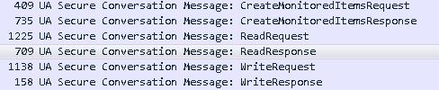

Other observations and questions:
A. Have the properties been actually improperly set (with version 2017.1 = 5.50) when you took this particular trace?
B. You have included some image (without further explanation) that were supposedly meant to show differences between the two versions. If you wanted to point to the fact of different sequence of the WriteRequest/response and ReadRequest/Response, then this should not be a problem, because the "Read" is for an internal housekeeping variable used to check the status of the subscription, and not for any of your own data items.
C. Even though I have not seen it in the particular trace with version 5.50, I can imagine a situation where the client sends a PublishRequest followed by a WriteRequest, receives WriteResponse, but then receives a PublishResponse with the "old" values. Client would then issue another PublishRequest, and the server would send a PublishResponse with proper, "new" values. Whether this will happen or not depends on the server implementation, and will tend to happen mainly shortly after the subscription is created, if it is followed quickly by a Write, because at that point the server may not yet have sent the initial value. But I would have to actually see that in the traces in order to be able to identify it as a cause.

01 Sep 2017 12:40 - 01 Sep 2017 12:41 #5473 by Captain_Dash
I recorded this behavior now with wireshark. How should I send you the wireshark files?
I saw that the order of some requests was switched, but I am not aware why this is happening. Our Code was the same in both versions, I only updated the quickOpc nuget package.
Added short snapshots of the order of requests which are different.
