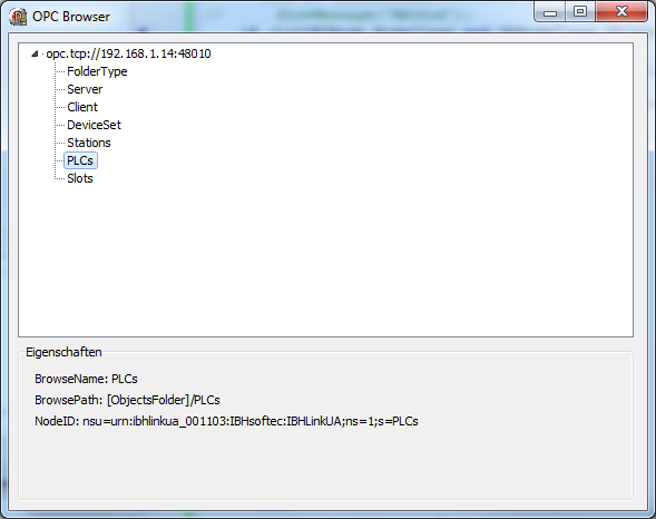

30 Sep 2016 14:00 - 30 Sep 2016 14:02 #4410 by support
Yes, just take the NodeId from the returned element, and use it for the parent.
I addition (but it is not necessary), I recommend that you also use the browsePath from the returned element, and use it for the parent as well. This way 1) The browse path returned will actually "grow" from the original starting point (Objects, in your case), instead of starting over again at the parent node, and 2) if the user in the end selects something, and you persist both the node Id and the browse path, and want to start the browsing again at the same point, you will have the information needed for that (in the browse path; the NodeId won't tell you "how" to get there from the Objects).
All namespaces are already filled in in the browse path returned from the BrowseXXXX methods, therefore you do not need to deal with them in any way for passing it over to further calls.

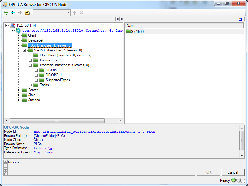

This is what my server looks like in your tool (I hope the attachments work):
I want to browse through the structure but I need some hint for getting there. What I have so far is the following (starting with the objects folder):
Can I browse using the nodeId of the current parent node? Do I need the DefaultNamespaceUriString when I have the nodeId like shown in my example?
30 Sep 2016 12:16 #4408 by support
1. A COM equivalent of .NET UAObjectIDs.Server:
To achieve that, create a new NodeDescriptor (you have that already), and then do something like this (I have not tested it, but it should work; if not, let me know):
NodeDescriptor.NodeId.StandardName := 'Server';
In this case you even do not need to use any browse path, in the example that is for demo purposes to show how to use them.
2. In case you wanted to start at a specific place in the server: In our example we specify that place using a browse path from the 'Objects' folder, and for that we parse the browse path, and yes, in this case the DefaultNamespaceUriString is server-specific. We could have also used some "direct" NodeId (server-specific).
There are "standard" nodes in UA servers - for those you can use the approach in 1) above. For anything server-specific, you are on your own. Either you somehow "know" the NodeIds or browse paths (e.g. from the server documentation), or you obtain them by earlier browsing.
3. For browsing for data, you usually start with the 'Objects' folder. But there are other starting places as well (such as for object types, reference types etc.). Understanding of OPC UA spec is needed here to decide what you need - it is a large spec and I cannot explain that in couple of sentences here.
