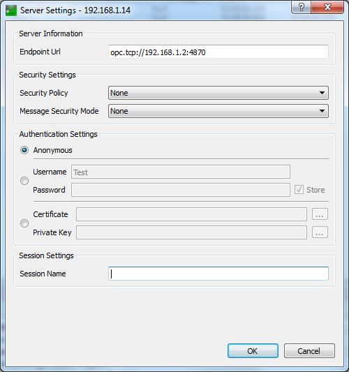

14 Oct 2016 10:57 #4466 by RH
We checked the Siemens software again and it turned out, that there are 2 endpoints. One unsecured and one secured. There is a possibility to enable just one of them.
With the unsecured endpoint disabled, I couldn't manage to connect to the secured endpoint, not even with UaExpert. But if we enable the unsecured endpoint and disable the secured one, then it's working. This seems to be enough for us for now. Thanks again for your help!

12 Oct 2016 13:11 #4451 by RH
I'm out of office and therefore can't check at the moment. But I have a screenshot for you to check. Actually, I selected "None" as security policy, that seems to be the reason. I attached a screenshot that might help you to understand whats happening.
I think, there is no demo version of this server as it's included in a Siemens Touchpanel. So you can just test it if you have this piece of hardware.
11 Oct 2016 08:16 - 11 Oct 2016 08:18 #4442 by support
As far as I can tell, after some checking, I think that the server is not compliant with OPC UA specs in this respect (I am not an expert in the details of the spec, though).
Related info: The problem appears to be in the response returned by the CreateSession call to the server. Spec Part 4, chapter 5.6.2, 5.6.2.2. The server returns serverSignature (SignatureData) that should be as follows:
This is a signature generated with the private key associated with the serverCertificate. This parameter is calculated by appending the clientNonce to the clientCertificate and signing the resulting sequence of bytes.
The SignatureAlgorithm shall be the AsymmetricSignatureAlgorithm specified in the SecurityPolicy for the Endpoint.
The SignatureData type is defined in 7.32.
Here the server returns an empty string for the SignatureAlgorithm. But for the Security of the Endpoint you are using (which is either Basic256 or Basic128Rsa15), the algorithm should be RsaSha1. This is specified in OPC UA spec Part 7 - Profiles, where (under 5.3 Transport and communication related features), it requires
AsymmetricSignatureAlgorithm – RsaSha1 – ( www.w3.org/2000/09/xmldsig#rsa-sha1 )
for these two security policies.
I am surprised that this works with UaExpert, but my guess is that with UaExpert, you are connecting to a different endpoint, possibly unsecured one. Can you please check precisely which endpoint you are connecting to with UaExpert?
In QuickOPC, you normally do not specify the endpoint so precisely - the selection of the endpoint is done using policies. Therefore you may end up with a different one, albeit on the same URL. If this proves to be the issue, I can later show you how to influence the selection of the endpoint in QuickOPC.
Is (a demo version of) this server available somewhere for download or test?
