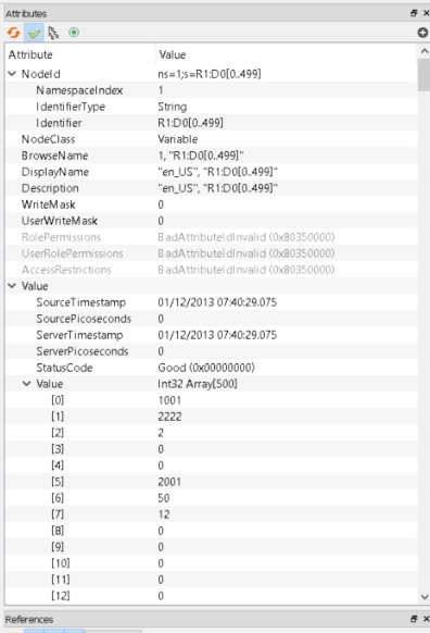

01 Dec 2023 16:29 #12422 by Scaglioni
Hello, I am unable to read/write array elements using indexing with GEFRA machines.
Here is the code I used to test the issue:
var value = easyUAClient1.ReadValue(
new UAReadArguments(
this._descriptor,
nodeIdTextBox.Text, UAIndexRangeList.OneDimension(1))
The error I received is:
'Opc.UA.ServiceResult=0x80360000/OPC UA service result - {BadIndexRangeInvalid}. The syntax of the index range parameter is invalid. [...]'
If I try to read/write the entire array, it works.
Example of code for reading the entire array:
var err = UAIndexRangeList.TryParse(string.Empty, out list);
if (err != null)
MessageBox.Show(err.ToString());
this._descriptor,
nodeIdTextBox.Text, list)
Is there something wrong with my code?.
This is the node I tried to read:
