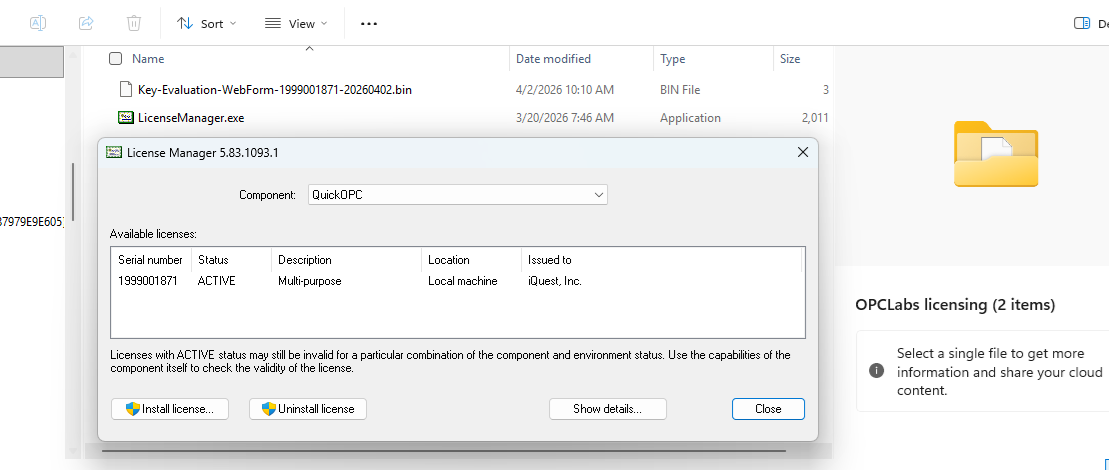

05 Apr 2026 07:32 #14592 by support
Replied by support on topic help with licensing
it looks like that QuickOPC does not "see" the evaluation license key installed through License Manager.
Are you embedding your original license key inside your project? If so, the embedded key takes precedence. You need to embed the evaluation license key instead in such case.

Hi, I am new to the forum. I have a license for EasyOPC back in 2019. I have upgraded to v 5.62 for compatibility with Server 2022.
I received a 30 day trial license for version 5.62 (an all versions). I can run the app in Visual Studios. But when I publish the app, I have issues. I have loaded the new trial license in License manager, and it shows in the license manager app. but the app throws an error. is this because I cannot use a trial license in a published app???
Is there something in the code I need to do in order for this to work? very link I visit about this seems to be broken. Not allowed to run by the license "Multipurpose". You might be running a trial license, and the version of the software you are using is obsolete. To resolve this problem, a) obtain a recent version, or b) ask for an evaluation license key, or c) install a license valid for the current version.
