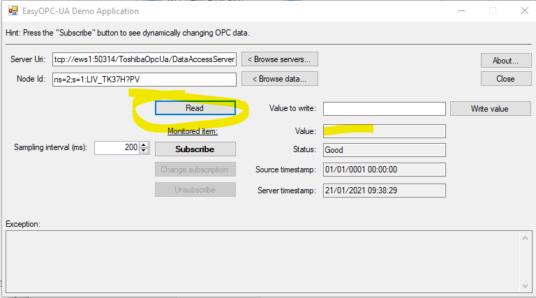

21 Jan 2021 11:09 #9348 by sistemi@resdata.it
support wrote: Hello,
I have some additional questions:
1. Please confirm that you are seeing this both with our demo client, *and* with your own code.
2. Can you describe the sequence of OPC operations that you program does before it gets to the problematic Read? For example, is this actually the very first operation made on the target server, or are there other operation before it? If there are more operations, how long (very roughly) is the time delay between the first operation, and the problematic Read? (is it almost immediate, or maybe several seconds, or much longer?). The reason I am asking is that I want to know whether the Read follows quickly after establishing the connection, or significantly later.
1. Yes
2. first attachment is your demo code with the exact endpoint and nodeid used to query the data
second attachment is the output of your demo code: attributedata is a valid object but value property is always empty/null
regards
JZ

21 Jan 2021 10:21 #9346 by sistemi@resdata.it
we have a very simple UA client (like example demo code) that must read tag values from an opcserver.
Even when using demo application provided with QuickOpc installation, we're able to read values only when using "subscription" to a specified tag.
Instead when we try the read functions we receive a valid response with Status good and timestamps but a null value.
(see image in attachment)
Can anyone explain this behavoir?
If we use an other opc client like UA-Expert we're able to read single values and subscriptions.
JZ
