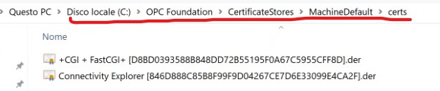

15 Feb 2023 18:30 #11543 by Pala
the contents of the folders are identical
screenshot and after Error
Fatal error: Uncaught com_exception: <b>Source:</b> Opc.Ua.Configuration<br/><b>Description:</b> OPC UA service result - {BadConfigurationError}. Cannot access certificate private key. Subject=CN=CGI / FastCGI. Cannot access certificate private key. Subject=CN=CGI / FastCGI

    Can you try to copy the whole "C:\OPC Foundation" structure over to "c:\ProgramData\OPC Foundation"? (keeping the original contents where not replaced).
    And, if you still get error, be careful in reading its details. It is really the same as before? (if things start working regarding the client certificate, the next common error is the validation of the server certificate, which looks similarly but is different).

    There are entries in the log that indicate where the problem is probably coming from, such as:
    Information(162): The OPC-UA engine will resolve the client instance certificate parameters directory store path to "\OPC Foundation\CertificateStores\MachineDefault".
    The directory is not correct - it should be "c:\ProgramData\OPC Foundation\CertificateStores\MachineDefault". In the component configuration, it is defined as "%CommonApplicationData%\OPC Foundation\CertificateStores\MachineDefault", and %CommonApplicationData% should resolve to "C:\ProgramData", but it appears that under this host, it resolves to an empty string.
