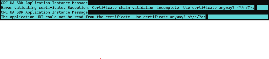

16 Jun 2026 12:24 #14653 by support
The "certificate chain validation incomplete" is more demanding to diagnose, so I would like to leave it for the second step.
The "The Application URI could not be read from the certificate" is critical. Certificates to be used as OPC UA application instance certificates must fulfil certain conditions, described in the OPC UA specifications. One of them is that the Application URI must be present and correct. In the certificate, it is represented as SubjectAltNameExtension. The error message indicates that there is no such extension in the certificate.
The ApplicationURI in the certificate is such a pivotal concept in OPC UA security, that nothing can really work correctly without it. Even accepting the message prompt would not bring you much further, because such certificate in invalid in OPC world and the OPC UA server will not accept it. So first thing to do is to generate the certificate that has the ApplicationURI (and it also fulfils other OPC UA requirements - see e.g. reference.opcfoundation.org/specs/OPC-10000-6/6.2.2 )
15 Jun 2026 07:29 #14652 by Kärcher
hi,
i'm still having some troubles here.
setting OrganizationName = "#" seems to work. But still i cannot get quickOpc to trust my certificate.
Here is snipped of the code i'm using:
Accepting any certificate given by the server. I think this should be irrelevant for my current issue.
EasyUAClient.SharedParameters.EngineParameters.CertificateAcceptancePolicy =     new UACertificateAcceptancePolicy()     {         AcceptAnyCertificate = true,     };
Setting the InstanceIssuerStorePath. Where in the given directory the public part of the root ca is placed withing a subfolder "certs" in the .der format
EasyUAApplication.Instance.ApplicationParameters.ApplicationManifest     .InstanceIssuerStorePath = @"C:\something\issuer\";
Loading the client certificate
var a = new UAImportCertificateArguments(pathToClientCert) {     SetNewPassword = false,     OldPrivateKeyPassword = <Password>,     CertificateTypeId = UACertificateTypeIds.RsaSha256ApplicationCertificateType, }; EasyUAApplication.Instance.ImportOwnCertificateOrCertificatePackFromFile(a);
Still i get the prompt as attached.
