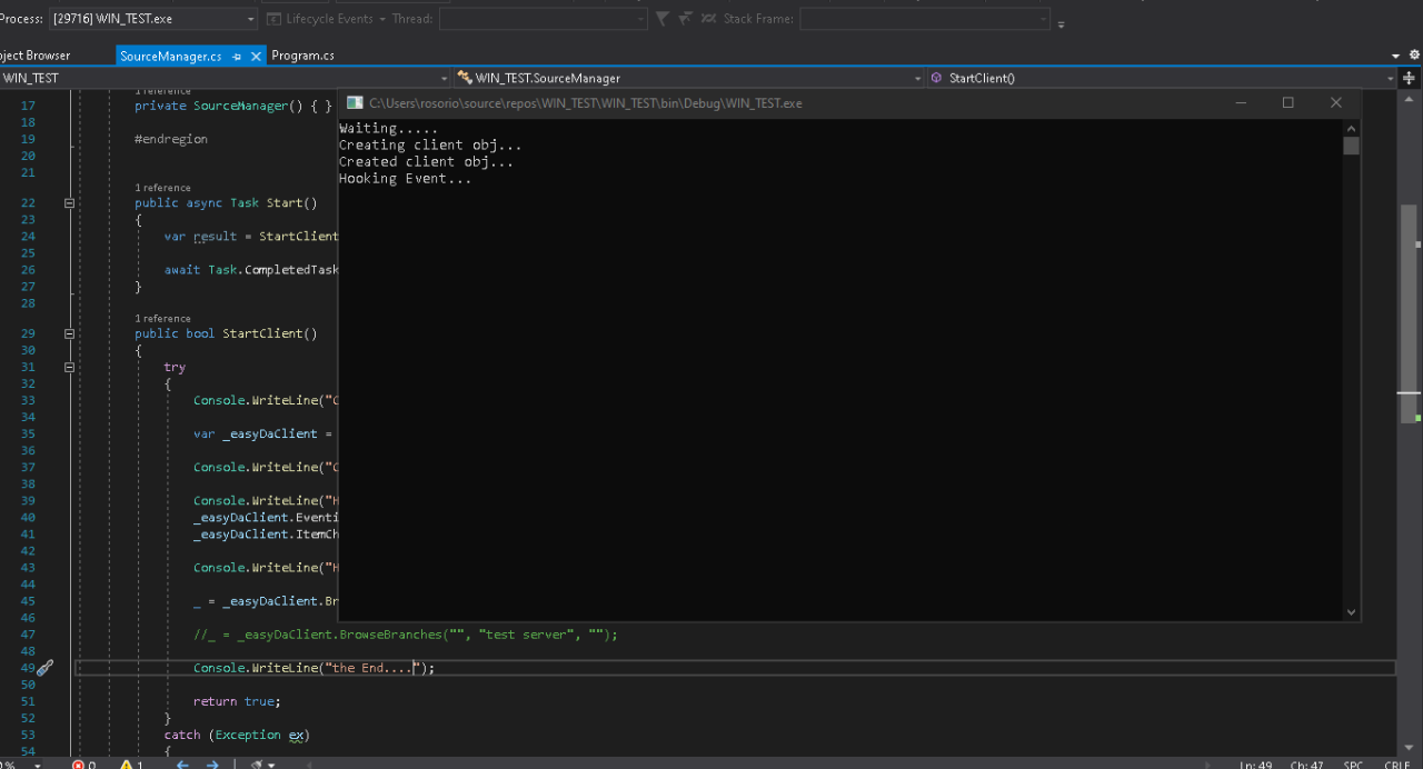

29 Apr 2022 07:52 - 29 Apr 2022 07:59 #10837 by support
Hi.
I was able to reproduce what you are seeing.
However, while the symptoms are quite similar as before, the cause of the problem is now different. What happens is that the assembly references in the project file are mixed up, and that causes the App_Web* assemblies to be not found.
There are multiple issues in the project file (WIN_TEST.csproj), e.g. there is:
<Reference Include="App_Web_OpcLabs.EasyOpcClassicRaw.amd64, Version=5.62.456.1, Culture=neutral, PublicKeyToken=6faddca41dacb409, processorArchitecture=AMD64"> <SpecificVersion>False</SpecificVersion> <HintPath>..\..\..\..\..\..\Program Files (x86)\Software Toolbox OPC Data Client 2021.3\Assemblies\net47\App_Web_OpcLabs.EasyOpcClassicRaw.amd64.dll</HintPath> </Reference> <Reference Include="App_Web_OpcLabs.EasyOpcClassicRaw.x86, Version=5.62.456.1, Culture=neutral, PublicKeyToken=6faddca41dacb409, processorArchitecture=x86"> <SpecificVersion>False</SpecificVersion> <HintPath>..\..\..\..\..\..\Program Files (x86)\Software Toolbox OPC Data Client 2021.3\Assemblies\net47\App_Web_OpcLabs.EasyOpcClassicRaw.x86.dll</HintPath> </Reference>
- this has an incorrect version/build number (5.62.456.1) compared to what the other assemblies have (5.62.1032.1), and in addition it leads to a path that's not inside the solution zip file.
When App_Web* assemblies are not found on the main thread (with lines 48-49 in Program.cs) present, it throws the exception you reported, and the whole program crashes.
When lines 49-49 in program.cs are commented out, the "not found" error then happens inside the task. In this case, unfortunately, it gets swallowed up and nothing is reported. So, the program is actually not "stuck" in "_easyDaClient.EventingFailure += OnEasyOpcDaEventingFailure;". It has thrown an exception there.
You can verify that this is the case by placing a breakpoint into the "catch" block of StartClient(), and inspecting the exception object ("ex").
Remedy:
1. In the project References, do "Manage NuGet Packages", and remove the OpcLabs.QuickOpc package
2. In the project References, remove any remaining OPC Data Clients assemblies. Specifically, remove the App_Web* assemblies.
3. In the project References, do "Manage NuGet Packages", and add the OpcLabs.QuickOpc package.
Note that when I first received your solution, I had removed the assembly references and replaced them with those that work on my system, without realizing that wrong assembly references can themselves be the cause. But the issue with BoxedApp exists as well I believe.

27 Apr 2022 15:30 #10831 by support
Thank you, I was able to reproduce the issue using your solution. And, the key is in the call stack you also provided - there, it can be seen that the program has blocked itself when trying to load one of the assemblies we have for OPC Classic.
However, I have very high confidence (although not 100% certainty) that there is nothing wrong in user's code, or our code. It looks like Microsoft problem. There is nothing else than simply loading that assembly (dynamically) inside the queued Task. This should work.

27 Apr 2022 04:02 #10829 by Restrepo
Hey, thank you for the quick reply.
Attached you have a sample application where the customer is able to replicate the behavior. If you run the application you can see that the code never passes the Hooking Event... line as seen on screenshot CosoleOutput.png.
The customer also was able to gather a trace which I have also included.
