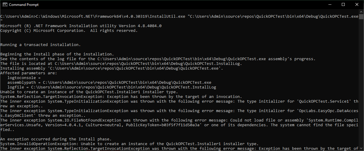

C:\Users\Admin>C:\Windows\Microsoft.NET\Framework64\v4.0.30319\InstallUtil.exe "C:\Users\Admin\source\repos\QuickOPCTest\bin\x64\Debug\QuickOPCTest.exe"
Microsoft (R) .NET Framework Installation utility Version 4.8.4084.0
Copyright (C) Microsoft Corporation. All rights reserved.
Running a transacted installation.
Beginning the Install phase of the installation.
See the contents of the log file for the C:\Users\Admin\source\repos\QuickOPCTest\bin\x64\Debug\QuickOPCTest.exe assembly's progress.
The file is located at C:\Users\Admin\source\repos\QuickOPCTest\bin\x64\Debug\QuickOPCTest.InstallLog.
Installing assembly 'C:\Users\Admin\source\repos\QuickOPCTest\bin\x64\Debug\QuickOPCTest.exe'.
Affected parameters are:
logtoconsole =
assemblypath = C:\Users\Admin\source\repos\QuickOPCTest\bin\x64\Debug\QuickOPCTest.exe
logfile = C:\Users\Admin\source\repos\QuickOPCTest\bin\x64\Debug\QuickOPCTest.InstallLog
Unable to create an instance of the QuickOPCTest.Installer1 installer type.
System.Reflection.TargetInvocationException: Exception has been thrown by the target of an invocation.
The inner exception System.TypeInitializationException was thrown with the following error message: The type initializer for 'QuickOPCTest.Service1' threw an exception..
The inner exception System.TypeInitializationException was thrown with the following error message: The type initializer for 'OpcLabs.EasyOpc.DataAccess.EasyDAClient' threw an exception..
The inner exception System.IO.FileNotFoundException was thrown with the following error message: Could not load file or assembly 'System.Runtime.CompilerServices.Unsafe, Version=4.0.4.1, Culture=neutral, PublicKeyToken=b03f5f7f11d50a3a' or one of its dependencies. The system cannot find the file specified..

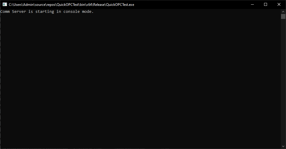

I am able to run the project inside VS 2022 and run the standalone .exe but when I try to install this project as a Windows Service using 'C:\Windows\Microsoft.NET\Framework64\v4.0.30319\InstallUtil.exe', I get the following error:
The transacted install has completed.
The installation failed, and the rollback has been performed.
