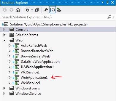

4. The ASP.NET examples are under the “Web” solution folder:
For the very first project, I recommend the project called “WebApplication1”.
