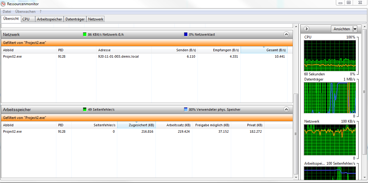

22 Mar 2018 11:11 #6171 by RVersteeg
Hello !
I have already Test our Application over a Weekend !
We write all 60 seconds the private Size, memory asured in a Excel File !
This File shows that the memory increase !
We have open the Resourcemonitor and that shows that the Size in "Zugesichert (KB)" periodic increase !
After the weekend, the Process was 1.5 GBYTE and windows message show "Not enough memory !"
