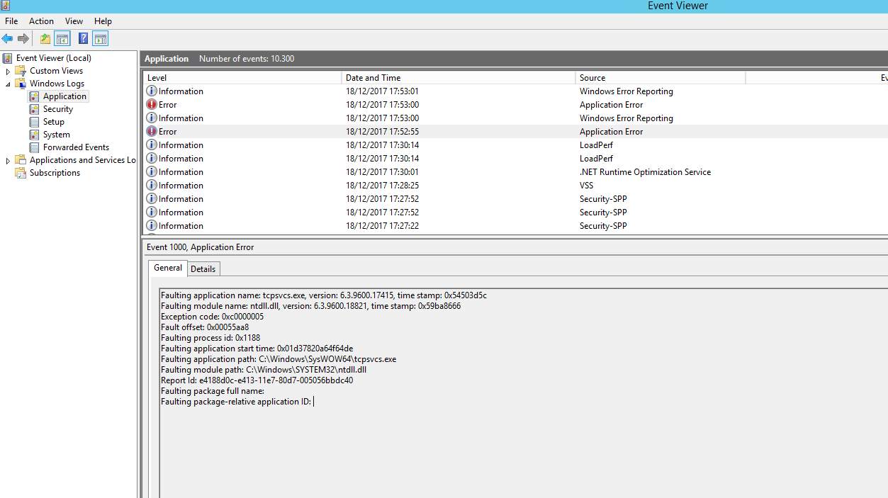

18 Dec 2017 16:59 #5744 by Scattolaro
In my Application I have this exception on OPC-UA client connect:
Exception: OpcLabs.EasyOpc.UA.OperationModel.UAException: An OPC-UA operation failure with error code -2147483648 (0x80000000) occurred, originating from 'System'. The inner OPC-UA service exception with service result 'Bad' contains details about the problem. ---> OpcLabs.EasyOpc.UA.UAServiceException: OPC-UA service result - Could not create a certificate via a proxy: The operation completed successfully.---- SERVICE RESULT ----StatusCode: {Bad} = 0x80000000 (2147483648) ---> System.ComponentModel.Win32Exception: The operation completed successfully at System.Diagnostics.Process.StartWithCreateProcess(ProcessStartInfo startInfo) at System.Diagnostics.Process.Start() at Opc.Ua.CertificateFactory.CreateCertificateViaProxy(String executablePath, String storePath, String password, String applicationUri, String applicationName, String subjectName, IList`1 domainNames, UInt16 keySize, DateTime startTime, UInt16 lifetimeInMonths, UInt16 hashSizeInBits, Boolean isCA, Boolean usePEMFormat, String issuerKeyFilePath, String issuerKeyFilePassword) --- End of inner exception stack trace --- --- End of inner exception stack trace --- at OpcLabs.EasyOpc.UA.EasyUAClient.InternalBrowseNodes(UAEndpointDescriptor endpointDescriptor, UANodeDescriptor nodeDescriptor, UABrowseParameters browseParameters) at OpcLabs.EasyOpc.UA.EasyUAClient.<>c__DisplayClassb.<BrowseNodes>b__a() at OpcLabs.EasyOpc.UA.EasyUAClient.DisposeGuard[TResult](Func`1 func) at OpcLabs.EasyOpc.UA.EasyUAClient.DisposeGuardNotNull[TResult](Func`1 func) at OpcLabs.EasyOpc.UA.EasyUAClient.BrowseNodes(UAEndpointDescriptor endpointDescriptor, UANodeDescriptor nodeDescriptor, UABrowseParameters browseParameters) at OpcLabs.EasyOpc.UA.IEasyUAClientExtension.BrowseDataNodes(IEasyUAClient easyUAClient, UAEndpointDescriptor endpointDescriptor, UANodeDescriptor nodeDescriptor) at OpcLabs.EasyOpc.UA.IEasyUAClientExtension.BrowseDataNodes(IEasyUAClient easyUAClient, UAEndpointDescriptor endpointDescriptor) at Qualitas.DeviceAppOPC.DataAccess.OPCserverCH.Open()(An OPC-UA operation failure with error code -2147483648 (0x80000000) occurred, originating from 'System'. The inner OPC-UA service exception with service result 'Bad' contains details about the problem.) Trace: at OpcLabs.EasyOpc.UA.EasyUAClient.InternalBrowseNodes(UAEndpointDescriptor endpointDescriptor, UANodeDescriptor nodeDescriptor, UABrowseParameters browseParameters) at OpcLabs.EasyOpc.UA.EasyUAClient.<>c__DisplayClassb.<BrowseNodes>b__a() at OpcLabs.EasyOpc.UA.EasyUAClient.DisposeGuard[TResult](Func`1 func) at OpcLabs.EasyOpc.UA.EasyUAClient.DisposeGuardNotNull[TResult](Func`1 func) at OpcLabs.EasyOpc.UA.EasyUAClient.BrowseNodes(UAEndpointDescriptor endpointDescriptor, UANodeDescriptor nodeDescriptor, UABrowseParameters browseParameters) at OpcLabs.EasyOpc.UA.IEasyUAClientExtension.BrowseDataNodes(IEasyUAClient easyUAClient, UAEndpointDescriptor endpointDescriptor, UANodeDescriptor nodeDescriptor) at OpcLabs.EasyOpc.UA.IEasyUAClientExtension.BrowseDataNodes(IEasyUAClient easyUAClient, UAEndpointDescriptor endpointDescriptor)
I found the error on EventViewer on Windows attachemnt on file
