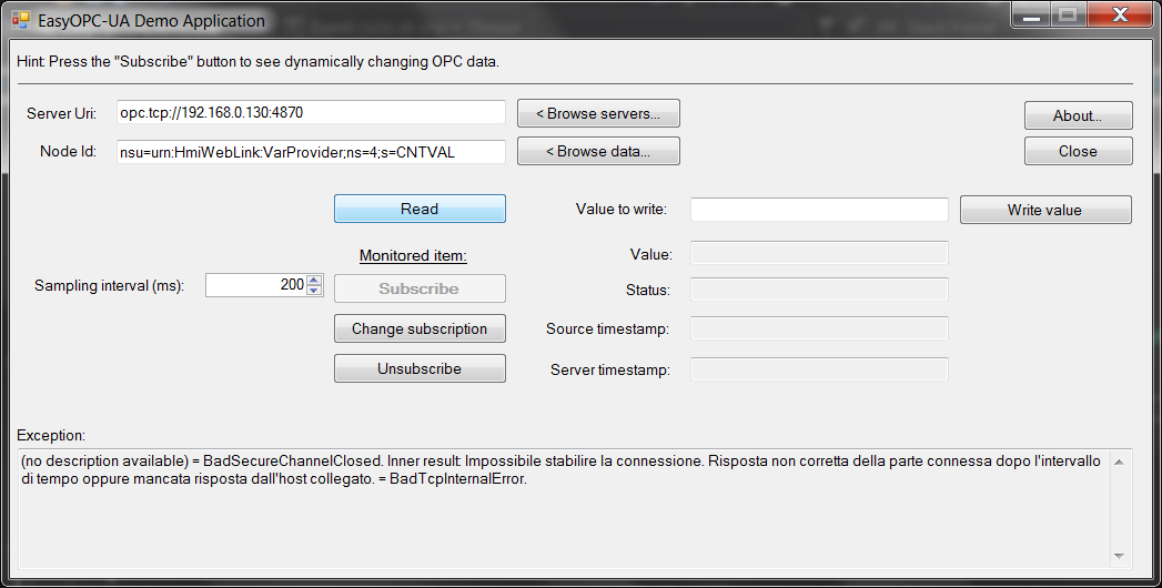

16 Jan 2018 07:11 #5873 by support
I know I have already referred you to a newer version, but in fact we have made yet another fix that was for an issue very similar to yours. The fix is currently only available in the "alpha" version of upcoming QuickOPC 2018.1 version. I will send you a private link to download it, to the email you have used to register with these forums. I would appreciate if you can give it a try.

15 Jan 2018 06:27 #5864 by support
Please just clarify before I respond in full: The problem is not in the error itself, but in the fact that the application hangs.
Is that correct?
12 Jan 2018 15:00 #5858 by Scattolaro
I try to update the QuickOPC to 2017.2 but the error persist.
then I try to debug step by step my application:
when fault the TCP/IP(unplug cable) connection from my application and OPC UA Server (that is in another PC) the EasyUAClient istance are freezing. If I try to call a method of object it lock my program.
So I try to use the EasyOPC-UA Demo Application and there is the same error:
I try to read and subscribe a node-id on my OPC-UA Server and it works fine.
After I unplug cable TCP/IP and retry to read the same node-id and it freeze the application(see the attachment).
Can you help me please?
