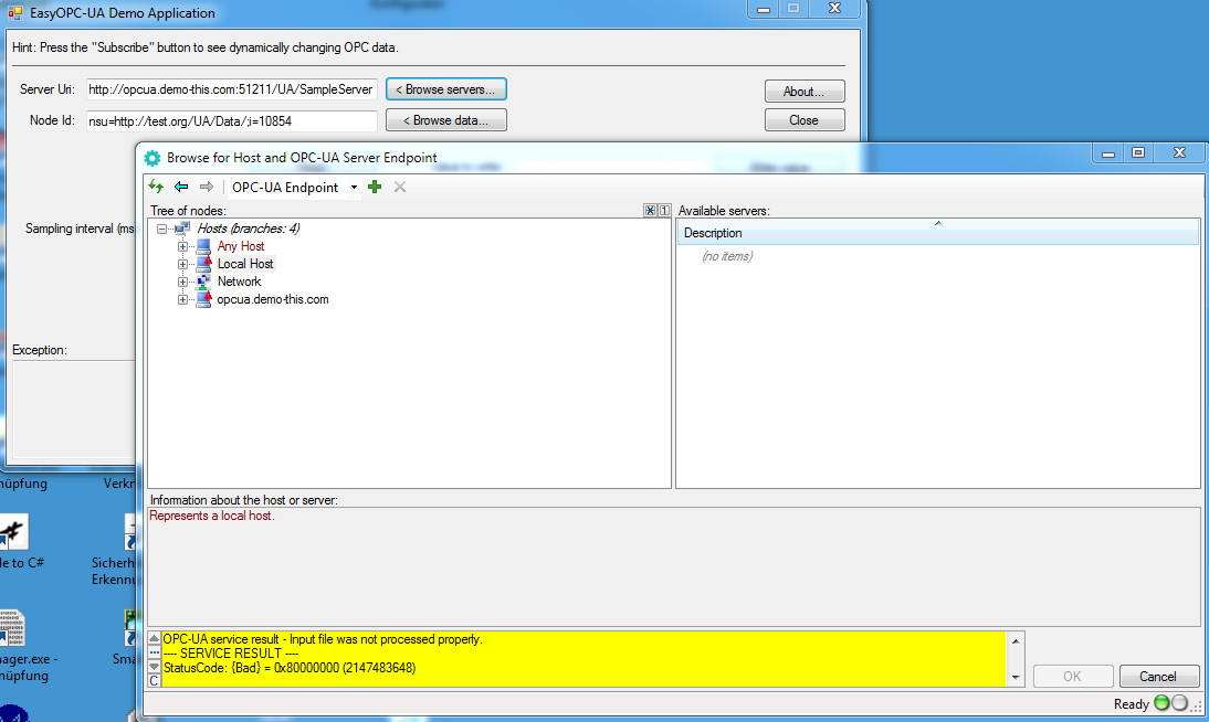

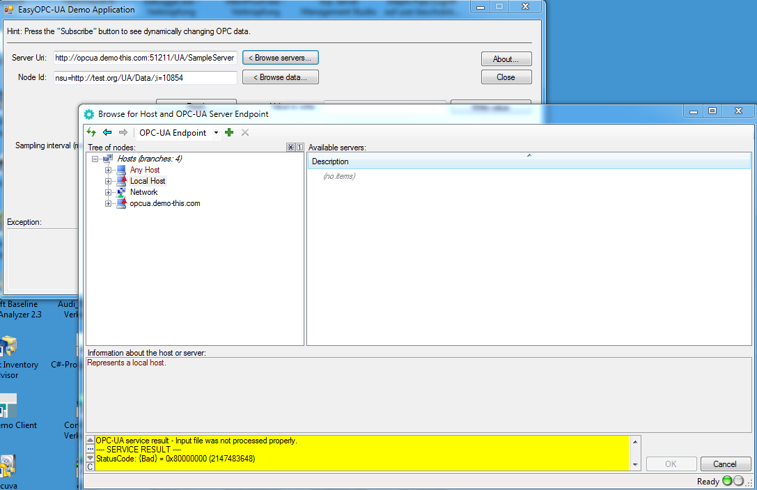

Hello, any body present? I need the connection local.
It donsn't also not work with your "EasyOpcUADemo.exe".
Not with start as User even not with start as Admin.

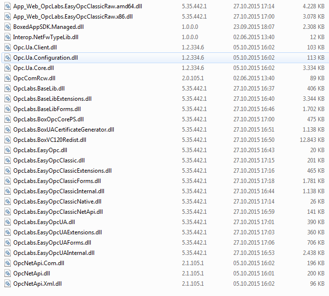

I need to know the full version and build number of QuickOPC. Please locate on of the assemblies (.DLLs) that start with OpcLabs.* in Windows Explorer, right-click on it, select Properties, then select the Details tab, and report the full version string of the file.

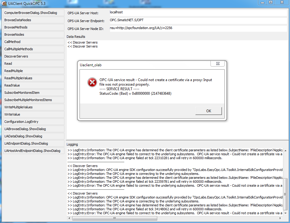

I use your QuickOPC UA 5.3.
We are programing in Delphi.
We have an IOManager with AddOn DLLs and have written our own OPC DA Client and server.
Now we want make a quick addon connection to Siemens UA Server with S7-1500 behind.
I used your ExamplesCom for OP and compiled it with XE5. Run OK.
To understand I wrote my own Client like the example but with a Form. Code is close to you example.
Working good.
I did the same in Delphi 2007 Win32, working good. (attached)
All is working good if the OPC-UA Server is remote. If the server is local I have the top error message.
Perhaps it is a problem of security. But in the sample is nothing shown about security.

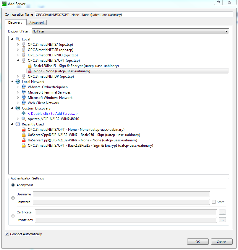

With a Unified Automation UaExpert Client is the connection to local with the Configuration Name : "OPC.SimaticNET.S7OPT - None - None (uatcp-uasc-uabinary)" possible.
We want to buy the QuickOPC 5.3 UA solution for our distributing, but first we have to test all functionallity.
Can you help me? What is wrong and what I have to do let the client run also local.
Were can I find documentation about my problem (the fault on top).
