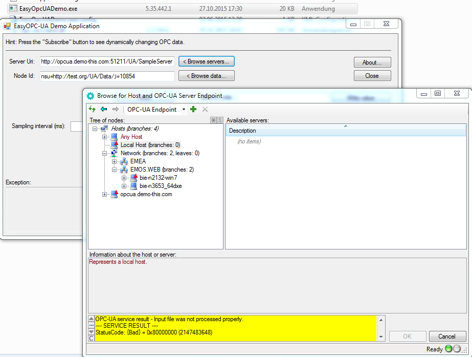

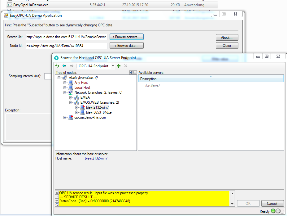

21 Jan 2016 12:40 #3804 by support
.NET Framework does not get "compiled into" the application. It must be installed on the target machine, and the .NET applications (including QuickOPC, event though in the end it behaves like a COM component) just make use of it.
For this reason, Visual Studio does not have to be installed in order to figure out the .NET Framework versions. What I need is 1) the operating system version, and 2) any installed .NET Framework version from the Control Panel (Programs). And, compare that between machines A) and B).
For the same reason, it is clear that EasyOpcUADemo doesn't work either on the problematic machine. This shows that there is nothing wrong with your app, it is how I suspected - something gets wrong between our component and the system or .NET Framework on machine A.
21 Jan 2016 11:44 #3801 by Manfred
first: I can't test the .NET Version on maschine A (were the OPC Server works), because there is not Visual Studio installed. Only on Maschine B.
But if I let run your EasyOpcUADemo.exe (I think is compiled in .net) it has the same result (see attach EasyOPC-UA Demo NET.PNG and EasyOPC-UA Demo NET_2.PNG)

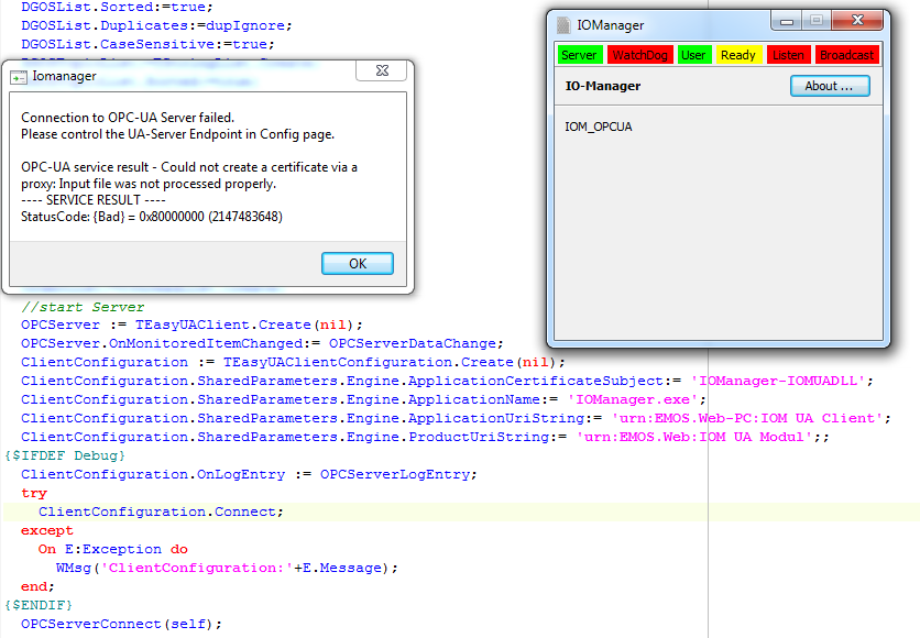

I'm not sure the setting of the SharedParameters are correct?
You can see what I did in WithSharedParameter.
With this Parameter it dosen't work at all.
For your understanding:
The appication Name is: IOManager.exe
The application load a DLL. Inside the DLL runs a thread with TEasyUAClient initialization.
We have other DLLs, has the same programing structure, but with OPC COM (DA).
The result of the test you can see in: WithSharedParameter.PNG
If I have to use other Parameters, please let me know.

21 Jan 2016 09:39 #3797 by support
Thank you - I understand now. I think that this further supports the point that the issue is not in the fact that a local server is being addressed; the issue is simply in some kind of "misunderstanding" between our component and the machine it is installed on. It would be interesting to compare the versions of .NET Framework on A and B - can you do that?
And, can you please try the following: Set certain parameters (that are otherwise determined automatically) from the code. The precise values do not matter that match. At the very of you application, instantiate the EasyUAClientConfiguration object, and set
.SharedParameters.Engine.ApplicationCertificateSubject = ...
.SharedParameters.Engine.ApplicationName = ...
.SharedParameters.Engine.ApplicationUriString = ...
.SharedParameters.Engine.ProductUriString = ...
There is a chance - not a big chance, but still a chance - that this will resolve the problem.
