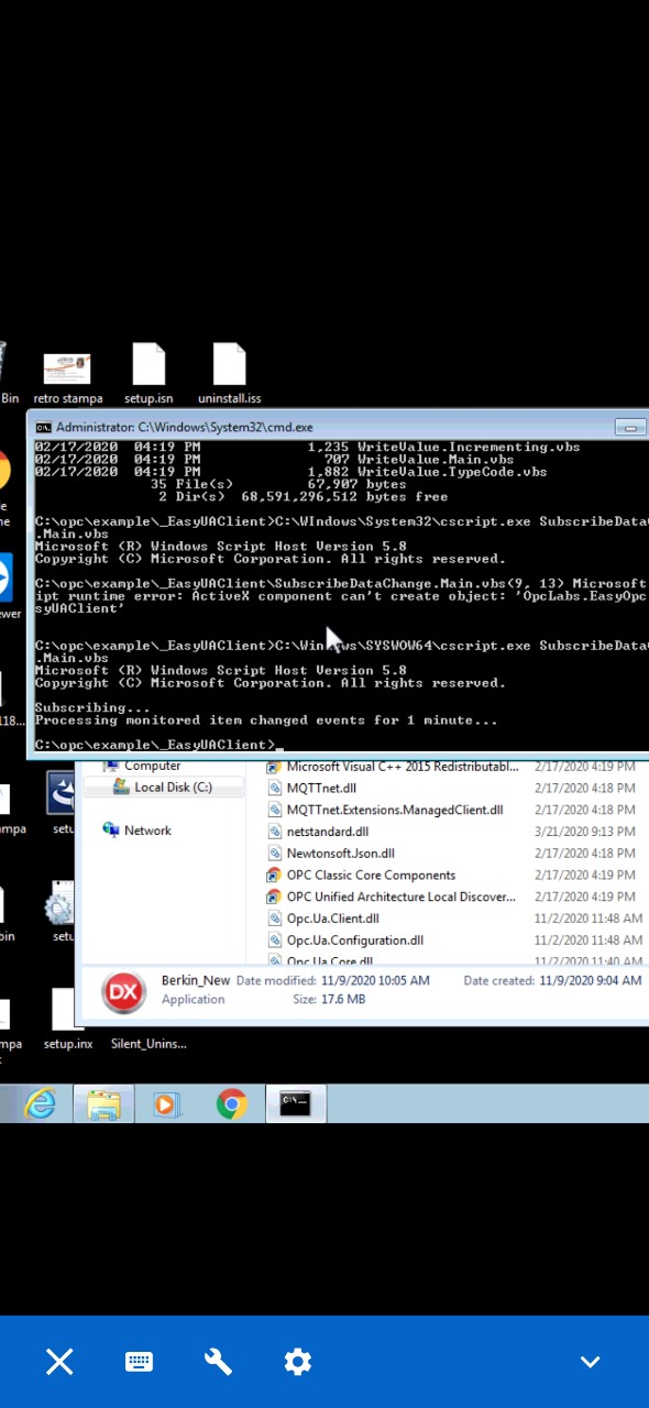

11 Nov 2020 16:07 #9129 by alr1976
Hi!
Works with cscript 64 bit but i have same result than delphi.
i got subscribing...but nothing happened.
I got this problem also with old versions that delphi app doesn t works and after that i reinstalled many times pc it worked but i need to solve this problem because i can t install industrial pc without internet connection....
Br,Alessandro
    11 Nov 2020 14:14 #9127 by support
    OK this is just because 64-bit CSCRIPT gets used instead of 32-bit one, or vice versa.
    Try using C:\Windows\SYSWOW64\cscript.exe ; if that does not work, try C:\WIndows\System32\cscript.exe .
    11 Nov 2020 08:24 #9123 by alr1976
    Hi!
    I got ActiveX error.
