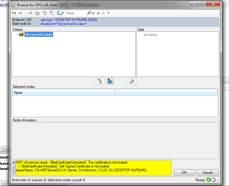

Browsing OPC UA Server (Kepware) - BadCertificateUntrusted - the certificate is
11 Jan 2023 13:42 #11438 by support
You have fixed the original problem. Good.
What you are seeing now is because your client app does not trust the server. This is a standard situation in OPC UA, not any kind of bug. The proper way to resolve it is to place the server's certificate into the "trusted peers" (...\UA Applications) cert store on the client side. This is made easier by the fact that it will now probably be found in ...\RejectedCertificates), so you can just copy the file, or use the UA Configuration Tool to make the move. Or, you can use OpcCmd.
See:
- opclabs.doc-that.com/files/onlinedocs/QuickOpc/Latest/User%2...%20Instance%20Certificate.html
- opclabs.doc-that.com/files/onlinedocs/QuickOpc/Latest/User%2...html#Certificate%20Stores.html
- opclabs.doc-that.com/files/onlinedocs/QuickOpc/Latest/User%2...ry%20Certificate%20Stores.html
- kb.opclabs.com/Using_OpcCmd_Utility_for_OPC_UA_Administration
11 Jan 2023 11:17 #11437 by micham
Note: The Kepware UA Server is running on a remote server. I could see the certificate on the local computer. I used the UA Configuration on the local computer, I have deleted the certificate on the local computer and saw it created again after I started my program.
On the Kepware server computer I couldn't see the certificate on the UA Configuration tool... I tried to export it and import it to the server computer, but my UA client keeps failing browsing. See the attached screen capture and the exception error below.
In Kepware server I don't see my certificate. It was not rejected by the Kepware server...
Please advise.
Exceptions
Type: OpcLabs.BaseLib.Browsing.BrowseException
OpcLabs.EasyOpc.UA.Engine.UAEngineException: UA SDK error (Opc.UA.ServiceResult=0x801A0000) in 'static Session.Create'. OPC UA service result - {BadCertificateUntrusted}. The certificate is not trusted.
+ Connection attempt #1; last connected at 01/01/0001 00:00:00 (local); unconnected for 00:00:00.1560000.
+ One reason for this error could be that the server certificate is not trusted by the client. The error can be resolved by properly configuring the certificate trusts. For development and testing purposes, or if your application does not require the server certificate check, you can set EasyUAClient.EngineParameters.CertificateAcceptancePolicy.AcceptAnyCertificate = true in your application to bypass the server certificate check on the client side, or (a bit safer), include the endpoint URL of your server in EasyUAClient.SharedParameters.EngineParameters.CertificateAcceptancePolicy.TrustedEndpointUrlStrings list.
+ The client method called (or event/callback invoked) was 'BrowseMultiple[1]'. ---> OpcLabs.EasyOpc.UA.UAServiceException: OPC UA service result - {BadCertificateUntrusted}. The certificate is not trusted.
--> {BadCertificateUntrusted}. Self Signed Certificate is not trusted.
IssuerName: CN=KEPServerEX/UA Server, O=Unknown, C=US, DC=DESKTOP-AUPBJMQ.
ErrorId_{045406CD-8EEA-4F21-B3D6-DC9DB5A34E58}: Opc.UA.ServiceResult=0x801A0000
OpcLabs.EasyOpc.UA.Implementation.ErrorEnhancingEasyUAClient.Processed: True
Help Link:
HResult: -2146232832 (0x80131600)
Internal Code: 2149187584
Message:
Service Result: BadCertificateUntrusted

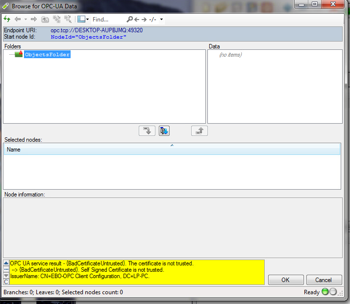

07 Jan 2023 09:58 #11422 by support
it looks like that the auto-generated application instance certificate is no longer valid. This can happen if it has simply expired, or I have seen it under unclear circumstances, possibly after some Windows update. The resolution is to remove it, which will cause a new one to be auto-generated on the next run.
The link I have provided has step-by-step instructions. What is not clear about them? In Step 6, remove the certificates that resemble "CN=EBO-OPC Client Configuration, DC=LP-PC".

05 Jan 2023 14:47 - 05 Jan 2023 14:48 #11412 by micham
Our customer is getting the attached error/exception. Any idea what is the problem?
The customer is able to browse using UA Expert.
Exceptions
OpcLabs.EasyOpc.UA.Engine.UAEngineException: UA SDK error (Opc.UA.ServiceResult=0x801A0000) in 'ApplicationInstance.CheckApplicationInstanceCertificate'. OPC UA service result - {BadCertificateUntrusted}. The certificate is not trusted.
+ The error occurred while creating or checking the (client) application instance certificate. Check event log entries for errors and warnings.
+ Suggestion: Check the trusted peers certificate store for the presence of the application instance certificate. This error can happen if the instance certificate is in the application instance store, but not in the trusted peers certificate store.
+ The certificate generator path was "C:\Program Files (x86)\Control-See\EBO-OPC Client\BIN\Opc.Ua.CertificateGenerator.exe".
+ This is an engine-level error. It is unrelated to any specific target server connection.
IssuerName: CN=EBO-OPC Client Configuration, DC=LP-PC.
Error Code: 1
Help Link:
Message:
Additional Info:
Description:
Inner Result: BadCertificateUntrusted
Additional Info:
--- at Opc.Ua.CertificateValidator.GetIssuersWithChainSupportEnabled(X509Certificate2Collection certificates, List`1 issuers)
--- at Opc.Ua.CertificateValidator.InternalValidateWithChainSupportEnabled(X509Certificate2Collection certificates)
--- at Opc.Ua.CertificateValidator.Validate(X509Certificate2Collection chain)
Description:
Inner Result:
Message:
Qualified Symbolic ID:
Expanded Text:
Is Null: True
Is Standard: True
Name:
Namespace Index: 0
Namespace URI:
Namespace URI String:
Standard Name:
Status Code: BadCertificateUntrusted
Code Bits: 32794
Code Bits Symbol: BadCertificateUntrusted
Condition: 26
Description: The certificate is not trusted.
Flag Bits: 0
Has Data Value Info: False
Info Type: NotUsed
Internal Value: 2149187584
Is Bad: True
Is Good: False
Is Uncertain: False
Limit Info: None
Overflow: False
Semantics Changed: False
Severity: BadOrFailure
Status Info: Error
Structure Changed: False
Text:
Message: The certificate is not trusted.
Expanded Text:
Is Null: True
Is Standard: True
Name:
Namespace Index: 0
Namespace URI:
Standard Name:
Code Bits: 32794
Condition: 26
Flag Bits: 0
Info Type: NotUsed
Is Bad: True
Is Good: False
Is Uncertain: False
Limit Info: None
Overflow: False
Status Info: Error
Text:
Service Target Site: Void Validate(System.Security.Cryptography.X509Certificates.X509Certificate2Collection)
DeclaringType: Opc.Ua.CertificateValidator
Module: Opc.Ua.Core.dll
Assembly: Opc.Ua.Core, Version=1.3.342.0, Culture=neutral, PublicKeyToken=6faddca41dacb409
CustomAttributes:
FullyQualifiedName: C:\Program Files (x86)\Control-See\EBO-OPC Client\BIN\Opc.Ua.Core.dll
MDStreamVersion: 131072
MetadataToken: 1
ModuleVersionId: de76a6af-12bb-481b-8ef7-2df5f7a00d0a
ScopeName: Opc.Ua.Core.dll
Source: Opc.Ua.Core
Stack Trace:
at OpcLabs.EasyOpc.UA.Toolkit.Sdk.ToolkitCertificateValidator.Validate(X509Certificate2Collection chain)
at Opc.Ua.CertificateValidator.Validate(X509Certificate2 certificate)
at OpcLabs.EasyOpc.UA.Toolkit.Sdk.ToolkitCertificateValidator.Validate(X509Certificate2 certificate)
at Opc.Ua.Configuration.ApplicationInstance.CheckApplicationInstanceCertificate(ApplicationConfiguration configuration, X509Certificate2 certificate, Boolean silent, UInt16 minimumKeySize)
at Opc.Ua.Configuration.ApplicationInstance.CheckApplicationInstanceCertificate(Boolean silent, UInt16 minimumKeySize)
at OpcLabs.EasyOpc.UA.Toolkit.ClientServer.UAClientServerEngineBase.<>c__DisplayClass61_0.<ValidateOrCreateClientCertificate>b__2()
at OpcLabs.EasyOpc.UA.Toolkit.UAEngineBase.PerformSdkAction(UASdkCallType callType, Func`1 usingFunction, String name, Action sdkAction)
TargetSite:
Message:
Source:
Stack Trace:
== Activity Trace ==
Following (6) events were gathered during the action on activity ID [21], in the order of first occurrence:
SDK trace: Checking application instance certificate.
SDK trace: Checking application instance certificate. CN=EBO-OPC Client Configuration, DC=LP-PC
2*Exception: {Opc.Ua.ServiceResultException} Self Signed Certificate is not trusted. IssuerName: CN=EBO-OPC Client Configuration, DC=LP-PC
SDK trace: Certificate 'CN=EBO-OPC Client Configuration, DC=LP-PC' rejected. Reason=BadCertificateUntrusted
SDK trace: Writing rejected certificate to directory: [Directory]%CommonApplicationData%\OPC Foundation\CertificateStores\RejectedCertificates
TargetSite:
Message: Problem browsing OPC Unified Architecture nodes.
Source:
TargetSite:
