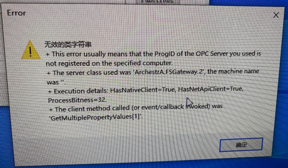

22 Dec 2021 06:16 #10491 by support
I do not know the cause, but one thing is for sure: In what you have reported before, the browse dialog was using the NET API client implementation. The error below indicates the usage of Native client implementation. While mixing the two approaches in one program is possible, it is not recommended. If you are setting the EnableNativeClient to 'false' (I might have recommended that earlier), it should to be done consistently in the whole program, at every place that creates either the EasyDAClient, or any of the browse dialogs/controls, in the corresonding property of the newly created instance.
Also - and that might be just imprecise formulation - I have problem with you writing "the following crash is observed using try-catch". The GetMultiplePropertyValues method does (should) *not* report operation errors by throwing an exception. It reports them by returning a non-null Exception object in the elements of the result array. If you wanted to state that a try-catch is needed to handle operation errors from this method, send me the related piece of code, because there is something seriously wrong either with your code, or our code.
21 Dec 2021 16:10 #10489 by micham
I have downloaded QuickOPC 2021.3 build 503.1 and used it in my product. I can browse now, but the following crash is observed using try-catch. See the attached screen capture.
Can you please advise?

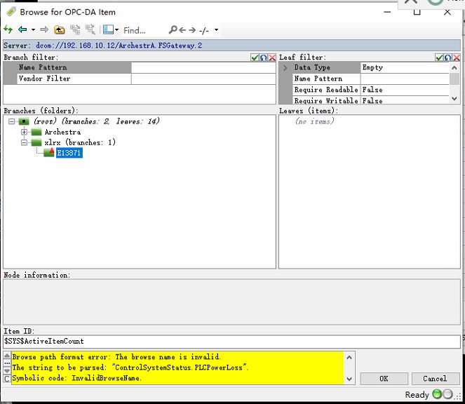

13 Dec 2021 07:37 #10471 by micham
We have a customer who is having a problem when browsing for items. The OPC Server is Wonderware FSGateway. See the attached screen capture and the exception details below.
com://192.168.10.12/ArchestrA.FSGateway.2
Exceptions
Type: OpcLabs.BaseLib.Browsing.BrowseException
OpcLabs.BaseLib.Navigation.Parsing.BrowsePathFormatException: Browse path format error: The browse name is invalid.
The string to be parsed: "ControlSystemStatus.PLCPowerLoss".
Symbolic code: InvalidBrowseName.
+ The client method called (or event/callback invoked) was 'BrowseNodes'.
? OpcLabs.BaseLib.Navigation.Parsing.BrowsePathParser.Parse(String value)
? OpcLabs.BaseLib.Navigation.BrowsePath.Parse(BrowsePath basePath, String value)
? OpcLabs.BaseLib.Navigation.BrowsePath..ctor(BrowsePath basePath, String value)
? OpcLabs.EasyOpc.Implementation.NetApi.DataAccess.NetApiEasyToOpcNetApiDa.ToDANodeElement(BrowseElement element, BrowsePath basePath, OpcTechnologies technology, Boolean isBranch, Boolean isLeaf)
? OpcLabs.EasyOpc.Implementation.NetApi.DataAccess.NetApiEasyToOpcNetApiDa.BrowseNodes(ServerDescriptor serverDescriptor, DANodeDescriptor parentNodeDescriptor, DABrowseParameters browseParameters)
OpcLabs.EasyOpc.Implementation.NetApi.NetApiErrorHarmonization.Processed: True
OpcLabs.EasyOpc.Implementation.ErrorEnhancement.Processed: True
OpcLabs.EasyOpc.Implementation.DAErrorEnhancement.Processed: True
Format Error: The browse name is invalid.
Code: InvalidBrowseName
CodeType: OpcLabs.BaseLib.Navigation.Parsing.BrowsePathFormatErrorCode
Message: The browse name is invalid.
HResult: -2146233033 (0x80131537)
Message:
Source: OpcLabs.BaseLib
TargetSite: OpcLabs.BaseLib.Navigation.BrowsePath Parse(System.String)
DeclaringType: OpcLabs.BaseLib.Navigation.Parsing.BrowsePathParser
Module: OpcLabs.BaseLib.dll
Assembly: OpcLabs.BaseLib, Version=5.61.284.1, Culture=neutral, PublicKeyToken=6faddca41dacb409
CustomAttributes:
FullyQualifiedName: C:\Program Files (x86)\Control-See\UCME-OPC\BIN\OpcLabs.BaseLib.dll
MDStreamVersion: 131072
MetadataToken: 1
ModuleVersionId: 75ae4e85-0a4b-40f4-8fe5-bed9dceb2e6d
ScopeName: OpcLabs.BaseLib.dll
Message: Problem browsing OPC Data Access (OPC-DA) leaves.
Source:
TargetSite:
