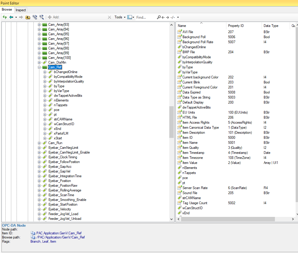

    This is the code that I am trying to get to run. It worked perfectly fine with the OPC DA functions but not for the OPC UA. As I was converting my program from DA TO UA this is the only part that breaks. I also attached a photo of Cam_Ref for DA

    For Cam_Ref, show me that some other OPC UA client can read or write it (its Value attribute). I do not think this is the case. I have explained that it is an Object, and UA Objects do not have values. You are asking for something that is not possible.

    Also, Cam_Ref is an OPC UA Object, so that explains why it does not have a Value attribute and you cannot read from it.
