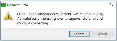

The UaExpert error message tries to tell you this - and you are overriding it.

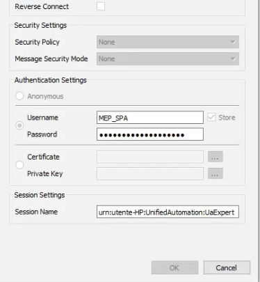

Here are the advanced settings also if that helps, although I didn't change anything from the default values.
    23 Jun 2022 14:11 #11009 by SolutionNow
    Yes, I enter the user name and password with UAExpert as well.

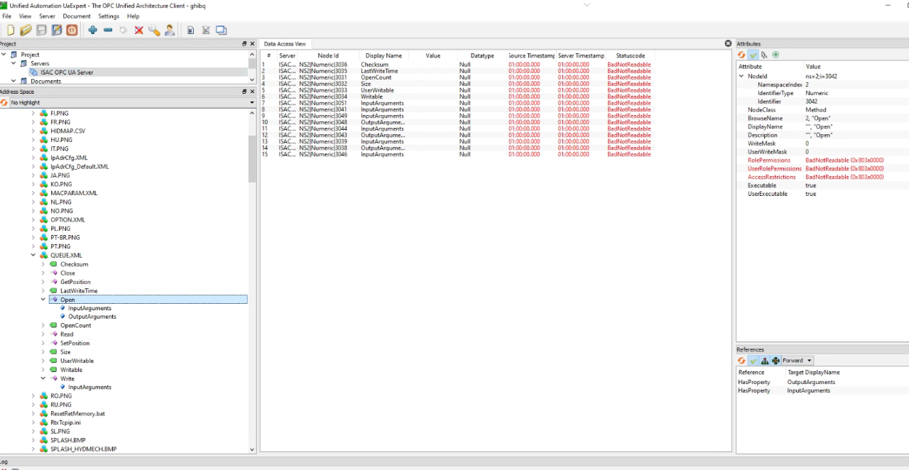

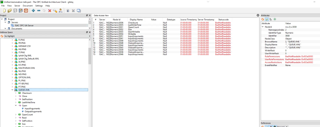

    The second endpoint is the method, and in fact I'm still not entirely clear when I call CallMethod() what endpoint is considered the MethodID and which is the MethodNodeID. There is a parent node QUEUE.XML:
    with an endpoint that ends with i=3030. This parent node then has several child parameters and methods including the one I tried to call in the second error I posted below, the method Open:
    which you can see has an endpoint ending with i=3042. Is it correct to set both the parameters methodID and methodNodeID with the endpoint ending with i=3042?

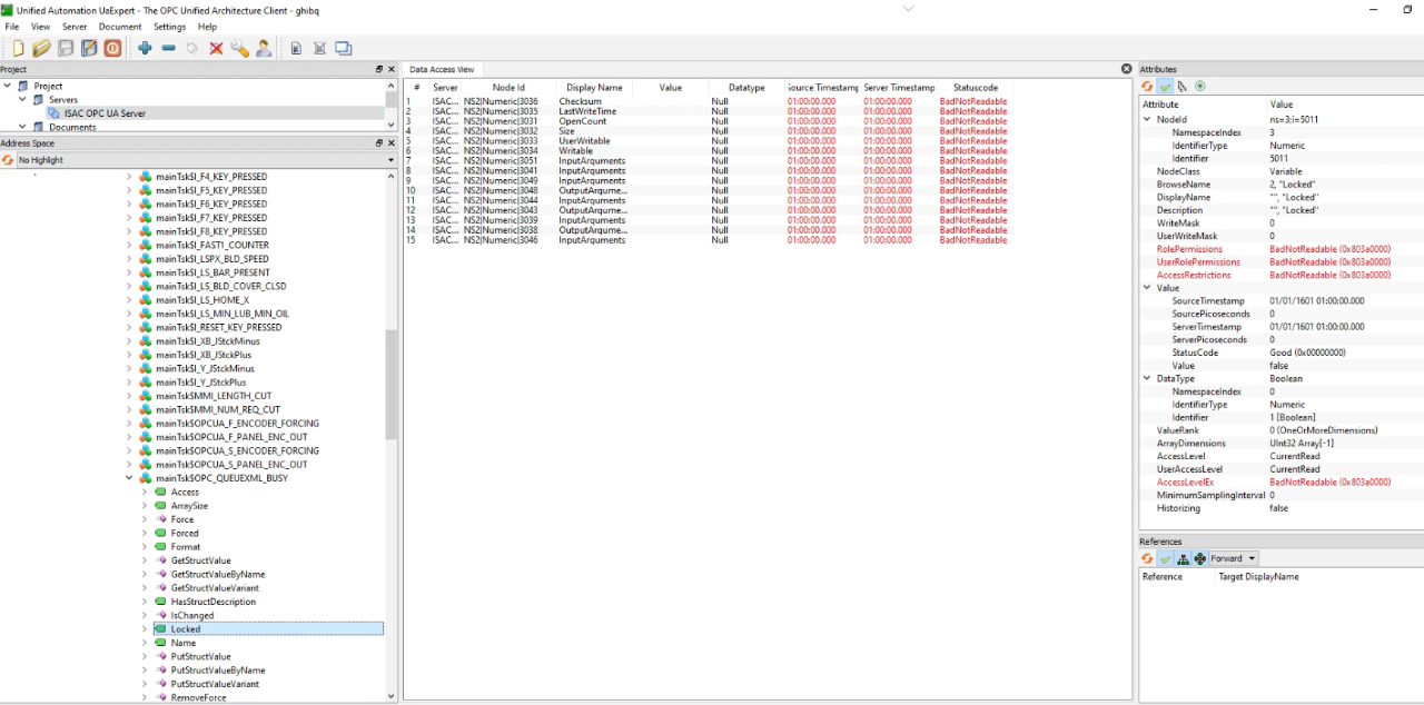

    I'm having difficulty writing values to an OPC Server. In general, I can read and monitor parameter values without any problem, but when I try to write to a parameter or call a method I'm getting authorization errors.
    I am trying to replicate a process for writing to the server sent by the producer of the machine with the server that shows a step-by-step tutorial for writing using UAExpert. One suspicious step in this tutorial regards the authentication process, which after entering the username and password advises that UAExpert will show this warning dialog:
    In UAExpert however, once this dialog is ignored, writing to parameters and calling methods works fine. With our program however I am getting first this error when writing to a parameter:
    Error Message: OPC-UA service result - (no description available) = BadSecureChannelClosed. ---- SERVICE RESULT ---- Status Code: {BadSecureChannelClosed} = 0x80860000 (2156265472) -=-=- ---- REMARKS ---- The server may have rejected the connection because it does not trust the client (e.g. certificate problem); check the diagnostics on the server side, if possible. A possible cause of this error could also be that the OPC-UA server is not running, or that it has rejected the connection due to security reasons. + The SDK action called was "Session.Read". + Following (9) events were gathered during the action on activity ID [1], in the order of first occurrence: SDK trace: Read Called. RequestHandle=36, PendingRequestCount=3 [33] SDK trace: TCPCLIENTCHANNEL SOCKET CLOSED: 000012BC, ChannelId=1 [35] Exception: {Opc.Ua.ServiceResultException} BadSecureChannelClosed [21] Exception: {Opc.Ua.ServiceResultException} BadSecureChannelClosed SDK trace: Read Completed. RequestHandle=36, PendingRequestCount=1, StatusCode=Bad [35] SDK trace: Publish Completed. RequestHandle=0, PendingRequestCount=2, StatusCode=Bad [21] SDK trace: Publish Completed. RequestHandle=0, PendingRequestCount=0, StatusCode=Bad [21] SDK trace: Publish #11, Reconnecting=False, Error: BadSecureChannelClosed [35] SDK trace: Publish #12, Reconnecting=False, Error: BadSecureChannelClosed + Events starting with activity ID in [] may not necessarily be related to the current action. + The client method called was 'WriteMultiple'. Stack: in OpcLabs.EasyOpc.UA.Toolkit.UAClientSession.InternalReadAttributes(UAReadEntry[] readEntryArray, Double maximumAge, TimestampsToReturn sdkTimestampsToReturn, Exception[]& exceptionArray, UAAttributeData[]& attributeDataArray, List`1[]& warningsArray) in OpcLabs.EasyOpc.UA.Toolkit.UAClientSession.ReadAttributes(UAReadEntry[] readEntryArray, Double maximumAge, TimestampsToReturn sdkTimestampsToReturn, Exception[]& exceptionArray, UAAttributeData[]& attributeDataArray, List`1[]& warningsArray) in OpcLabs.EasyOpc.UA.Toolkit.UASmartSession.ReadAttributes(UAReadEntry[] readEntryArray, Double[] maximumAgeArray, Exception[]& exceptionArray, UAAttributeData[]& attributeDataArray, List`1[]& warningsArray) in OpcLabs.EasyOpc.UA.Implementations.NetSdk.Internal.EasyUASession.ReadListInternal(List`1 readList, UAAttributeDataResult[] attributeDataResultArray) in OpcLabs.EasyOpc.UA.Implementations.NetSdk.Internal.EasyUASession.ReadList(List`1 readList, UAAttributeDataResult[] attributeDataResultArray) in OpcLabs.EasyOpc.UA.Implementations.NetSdk.Internal.EasyUASession.<ReadTypeInformation>d__24.MoveNext() in OpcLabs.EasyOpc.UA.Implementations.NetSdk.Internal.EasyUASession.ObtainTypeInformationInternal(ValueArguments`1[] nodeDescriptorArgumentsArray, ValueResult`1[] typeInformationResultArray) in OpcLabs.EasyOpc.UA.Implementations.NetSdk.Internal.EasyUASession.ObtainTypeInformation(IEnumerable`1 nodeDescriptorArgumentsEnumerable) in OpcLabs.EasyOpc.UA.Implementations.NetSdk.Internal.EasyUASession.ResolveWriteList(List`1 resolveWriteList, ICollection`1 internalWriteList, UAWriteResult[] writeResultArray) in OpcLabs.EasyOpc.UA.Implementations.NetSdk.Internal.EasyUASession.WriteList(List`1 writeList, UAWriteResult[] writeResultArray) in OpcLabs.EasyOpc.UA.Implementations.NetSdk.Internal.EasyUAEngine.Write(ICollection`1 writeListDictionary, UAWriteResult[] writeResultArray) in OpcLabs.EasyOpc.UA.Implementations.NetSdk.Internal.EasyUAEngine.WriteAttributes(UAWriteArguments[] writeArgumentsArray, EasyUAAdaptableParameters easyUAAdaptableParameters) in OpcLabs.EasyOpc.UA.Implementations.NetSdk.Internal.NetSdkEasyUAClient.DisposeGuard[TResult](Func`1 func) in OpcLabs.EasyOpc.UA.Implementations.NetSdk.Internal.NetSdkEasyUAClient.WriteMultiple(UAWriteArguments[] writeArgumentsArray) in OpcLabs.EasyOpc.UA.Internal.DataConvertingEasyUAClient.WriteMultiple(UAWriteArguments[] writeArgumentsArray) in OpcLabs.EasyOpc.UA.Internal.LicensingEasyUAClient.WriteMultiple(UAWriteArguments[] writeArgumentsArray) in OpcLabs.BaseLib.Collections.Generic.Extensions.IReadOnlyListExtension.SwitchCase[TInput,TOutput,TKey](IReadOnlyList`1 readOnlyList, Func`2 keySelector, IEqualityComparer`1 keyComparer, Func`3 outputSelector) in OpcLabs.EasyOpc.UA.Internal.MultiplexingEasyUAClient.WriteMultiple(UAWriteArguments[] writeArgumentsArray) in OpcLabs.EasyOpc.UA.Internal.ExceptionProcessingEasyUAClient.WriteMultiple(UAWriteArguments[] writeArgumentsArray) in OpcLabs.EasyOpc.UA.IEasyUAClientExtension.WriteMultipleValues(IEasyUAClient client, UAWriteValueArguments[] writeValueArgumentsArray) in OpcLabs.EasyOpc.UA.IEasyUAClientExtension.WriteValue(IEasyUAClient client, UAWriteValueArguments writeValueArguments) in OpcLabs.EasyOpc.UA.IEasyUAClientExtension.WriteValue(IEasyUAClient client, UAEndpointDescriptor endpointDescriptor, UANodeDescriptor nodeDescriptor, Object value)[...]
