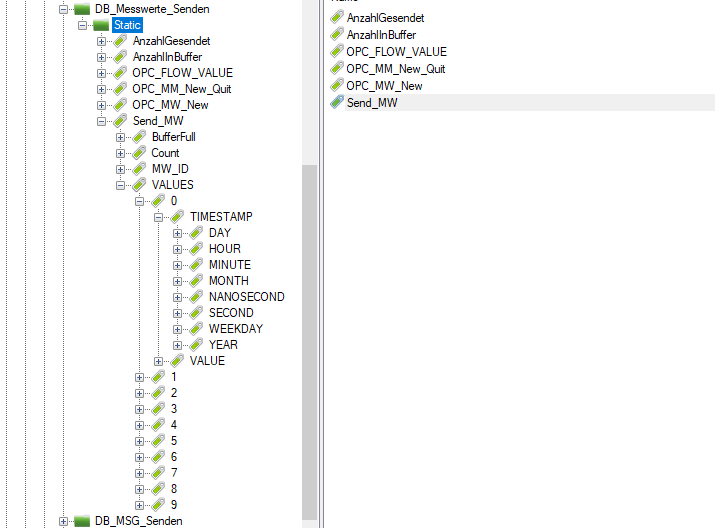

12 Jan 2021 12:54 #9330 by support
Replied by support on topic Error Version 2020.3
can you please provide some information?
1. What is the last version that has worked - was it QuickOPC 2020.2, or something older?
2. Can you still run you program built with the same version , and does it still work today? (just making sure that the problem is truly in the change in QuickOPC and not in some change elsewhere).
3. Can you send me or somehow what is an example of correct (expected) data read, from the old version?
4. What precisely happens with QuickOPC 2020.3? Do you get an error? If so, what is the error? Or are there other symptoms?
P.S. For easier work, I am attaching the picture from your document right below.
    11 Jan 2021 08:51 #9329 by Werner.Gall@gapo.de
    es gibt ein Problem in der Version 2020.3 das in den Versionen davor nicht vorhanden ist.
    Das lesen einer bestimmten komplexen Struktur aus einer S71500 geht nicht mehr.
    Der Aufbau der Struktur "Send_MW" ist im Anhang beschrieben
