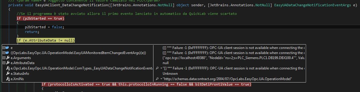

22 Nov 2017 14:13 #5672 by I-Tecnology
Replied by I-Tecnology on topic Subscription
Sorry for the late, but I make some tests.
I modified my plc program to fire just 1 event on 1 bit variable only when I command it.
At startup it seems all ok. DatachangeNotification are right.
After about 1 minute, are fired some events (without any variable changes) with subscription errors, see attacched image.
I also paste the errrors:
e {[] *** Failure -1 (0xFFFFFFFF): OPC-UA client session is not available when connecting the client subscription.} e.Arguments {"opc.tcp://localhost:49380", "NodeId="ns=2;s=PLC_Siemens.PLC1.DB199.DBX100.4"", Value} http://schemas.datacontract.org/2004/07/OpcLabs.EasyOpc.UA.OperationModel
Any suggestion?
