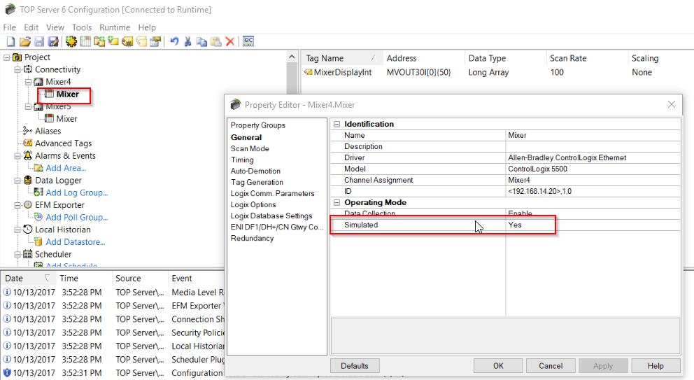

To reproduce the scenario where 1 device is in a “down” state and the other is in a “running” state, you can check the “Simulated” property of one of the devices in TOP Server:
When a device is in “Simulated mode”, TOP Server fills in all of the tags with simulated values – so the client will get a good response. Leaving the other device in non-simulated mode, TOP server will go out and try to request data from the device, which will timeout.
