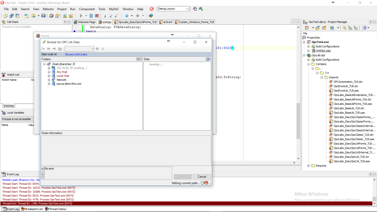

17 Jan 2017 10:10 #4769 by support
Replied by support on topic Delphi
I am sorry but this is a misunderstanding of what the dialog (or its design) is supposed to do.
You do not design the properties of the dialog by running the "Test", if that's what you are doing. The only things that "design" the dialog are those that can be seen in its properties (look at the Properties window), but - and that is probably what confuses you - *not* those that appear under Input, Output, or Input/Output categories. All of these are ephemeral and should be passed into/taken from by the code, each time the dialog is invoked.

16 Jan 2017 20:08 #4765 by support
I understand what you want to achieve, but the behavior is by design. There is no "storage" for stuff that the user does inside the dialog, besides what is available through its properties.
You can, however, store the selected data yourself, and then pass them back to the dialog. That can be just one element (when MultiSelect = false), or multiple elements (when MultiSelect = true).

16 Jan 2017 16:41 #4763 by support
I am not 100% sure if I understand the request, but I will try to answer it in the way I understand.
The dialog documentation is here: opclabs.doc-that.com/files/onlinedocs/QuickOpc/Latest/User%2...ml#OPC-UA%20Data%20Dialog.html .
The purpose of the dialog is to allow the user to select one data node from an OPC UA server. You can either
Have UserPickEndpoint = false, and pass a server's EndpointDescriptor from your code. In this case the user will be forced to use the server your code have chosen, and only nodes from that server will be shown. Or,
Have UserPickEndpoint = true. In this case the user will be able to freely select an OPC UA server. You can also pass in an EndpointDescriptor, and that will be become a "starting point", but the user will be able to select a different server as well. With UserPickEndpoint = true, servers on the local host, servers on the Windows network, and server on our demo site can be selected (if a an OPC UA Local Discovery Server runs on the corresponding host). In addition, the user can connect to ANY accessible server, by using the "+" icon on the toolbar, and manually entering its URL.
The dialog currently does not allow you to pass in two or more "favorite" server URLs, which is what I understand may be what you are looking for. If this is the case, and asking the user to manually enter the URL is not an options, I suggest that you design your application in such a way that the user somehow picks the server first in some other form of your app, and then the UADataDialog is shown to him, with the nodes from the server only.
16 Jan 2017 16:13 #4762 by alr1976
Replied by alr1976 on topic Delphi
Please answer me about hosts. Post above with image

16 Jan 2017 15:27 - 16 Jan 2017 16:32 #4760 by alr1976
Ok i have dialogs with this code:
var DataDialog: TUADataDialog; begin // Instantiate the dialog object DataDialog := TUADataDialog.Create(nil); //DataDialog.SetEndpointDescriptors(null); DataDialog.EndpointDescriptor.UrlString := 'opc.tcp://102.16.92.181:9320'; // DataDialog. // showmessage(DataDialog.EndpointDescriptor.ToString); DataDialog.UserPickEndpoint := True; if (DataDialog.ShowDialog(nil) = DialogResult_OK) then begin endpoint.text := DataDialog.EndpointDescriptor.ToString; variable.text := DataDialog.NodeElement.ToUANodeDescriptor.NodeId.ToString; end;
But in My host list i have:
  • opc.tcp://102.16.92.181
  • AnyHost
  • Local Host
  • Network
  • opcua.demo-this.com
I need to have:
  • My Server (With Node opc.tcp://127.0.0.1:9320)
  • Remote Server (With Node opc.tcp://102.16.92.181:9320)
It is possible to do? and How?
