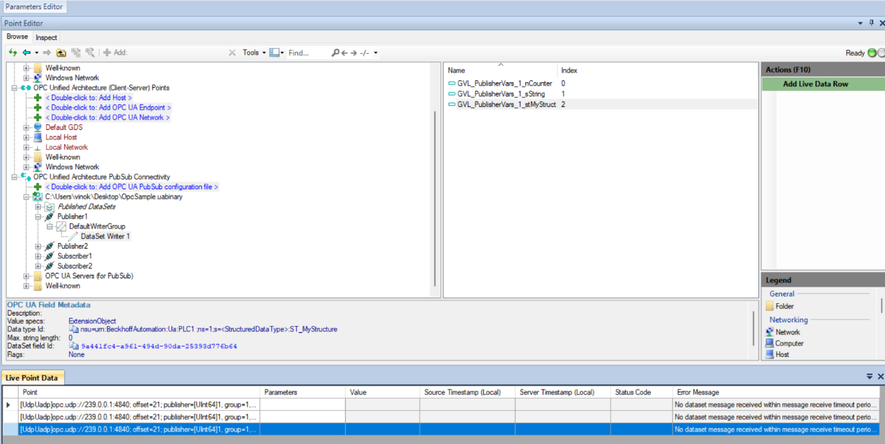

Sorry image pointer was not correct for your third question. Please find the right image

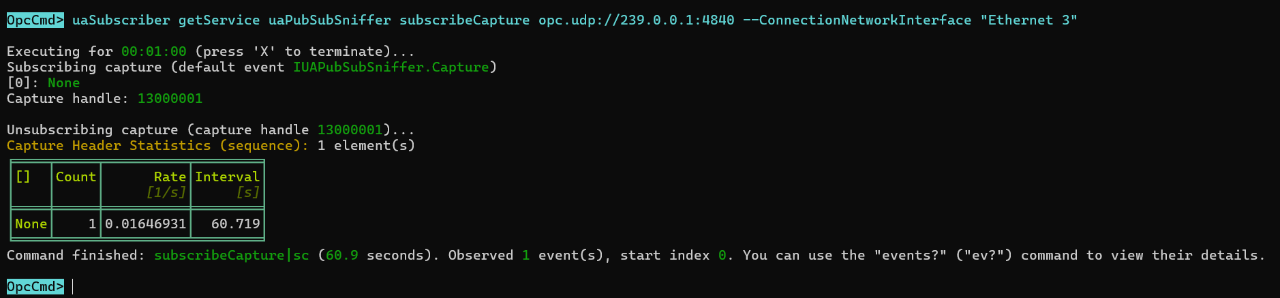

    uaSubscriber getService uaPubSubSniffer subscribeCapture opc.udp://239.0.0.1:4840 --ConnectionNetworkInterface "Ethernet 3"
    This should capture all UA UADP communication (no filtering) on that interface&broadcast address.
    What is the output please?

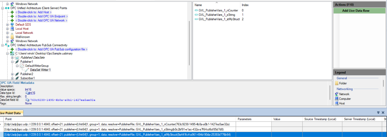

    Question 3: In the Live Point Data (bottom part) of the Connectivity Explorer, please make the first column (Point) so wide that I can see the whole text, and post the image here again.
    Thank you, and best regards

    2. Please start the OpcCmd utility (included with the product) and enter the following command:

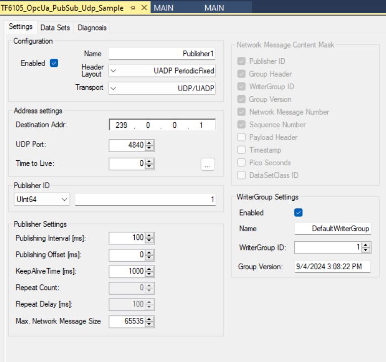

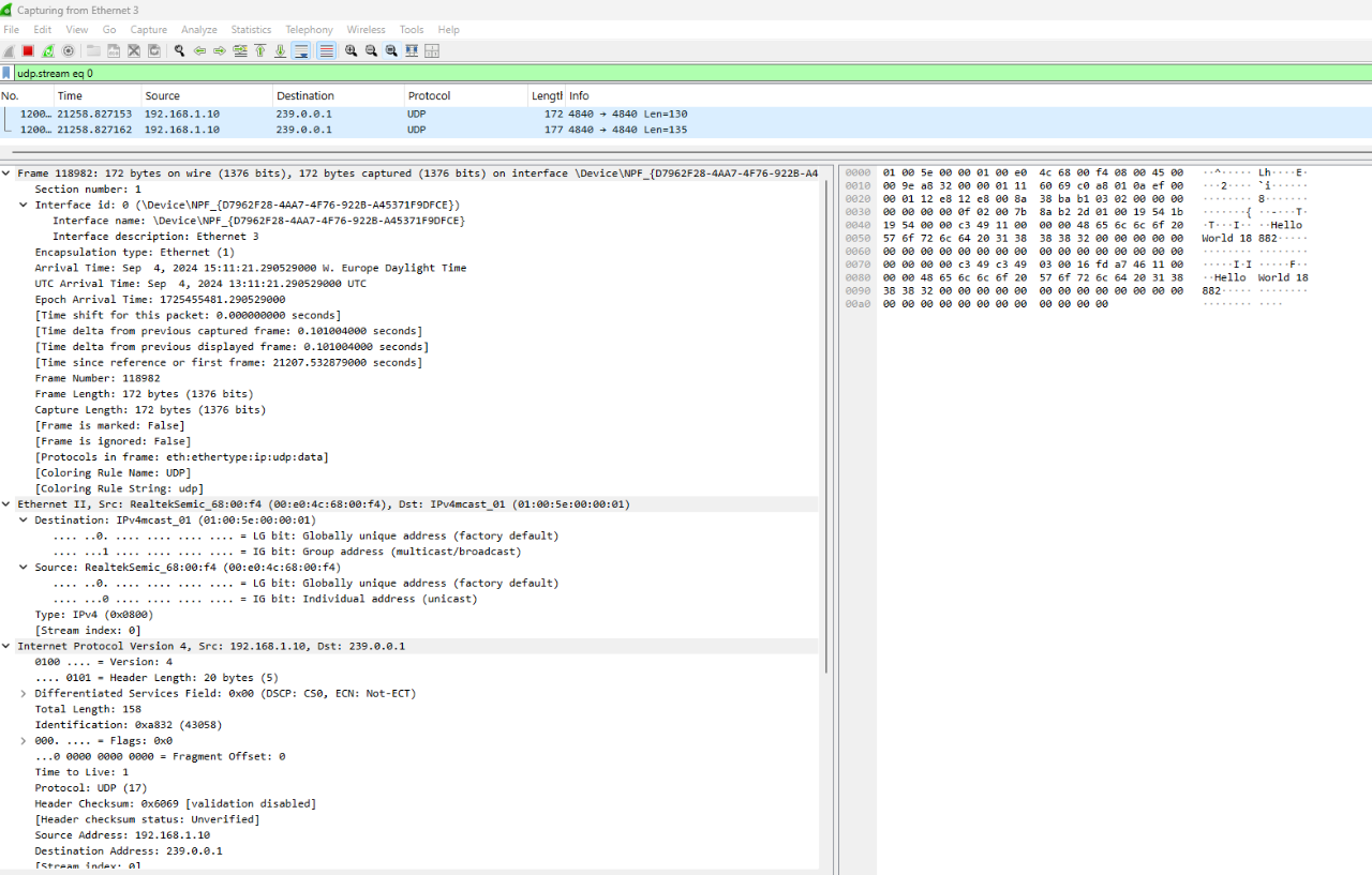

    I am using OPC UA (UDP) PubSub in Beckhoff TwinCAT and publishing OPC UA datasets from Twincat runtime. I do not have PLC but I am running the PLC project on my local PC on Ethernet interface; my C# WPF application will also run on same local PC. please refer beckhoffSettings screenshot

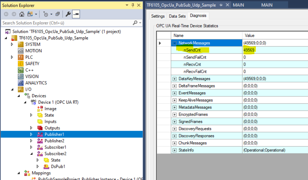

    In TwinCAT, I can see the packets being sent through nSendCnt in Diagnosis tab
    And I can able to capture the data packets in wireshark.

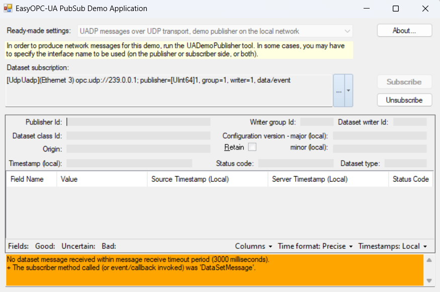

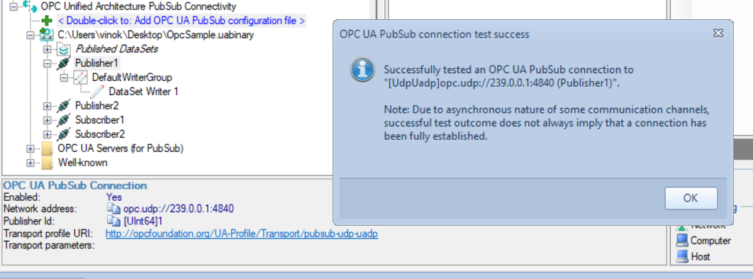

    I tried using Connectivity explorer and used the uabinary file to test the live point data, I can able to Test PubSub Connection successfully but I cannot able to get the live data and received the following error message "No dataset message received within message receive timeout period (3000 millisec)" for each point or field.
    I even tried using EasyOpcUAPubSubDemo application, I got the same results, I can test connection but I am unable to subscribe to the datasets and same error message "No dataset message received within message receive timeout period (3000millisec)"
