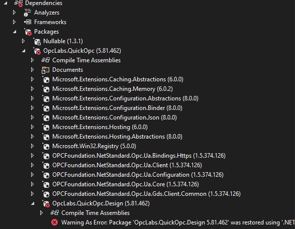

Screenshot 2024-11-28 154726.jpg - error after try to insert with nuget-package-manager
Screenshot 2024-11-28 154832.jpg - depdendency-error-info after editing csproj file manually

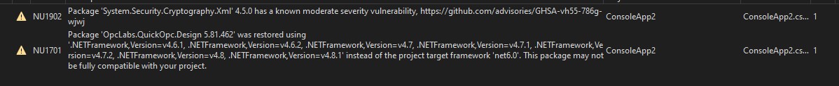

Screenshot 2024-11-28 154959.jpg - warning if target-framework net6.0 and TreatWarningsAsErrors set to false
28 Nov 2024 14:28 #13295 by support
What is the warning you are getting?

We are using <TreatWarningsAsErrors>true</TreatWarningsAsErrors> and so it is not possible to install or use 5.81.462 in our scenario.

The newest version 5.81.462 has one internal dependency OpcLabs.QuickOpc.Design and this library is working on Net4.7.2 and net6.0-windows7.0.
But we are using the opc-library cross-plattform, so we also have to build it for linux.
So in our project we cannot use net6.0-windows, we have to use .net6 or .net8 in our scenario.
Is there a OpcLabs.QuickOpc 5.81.462 for linux?
