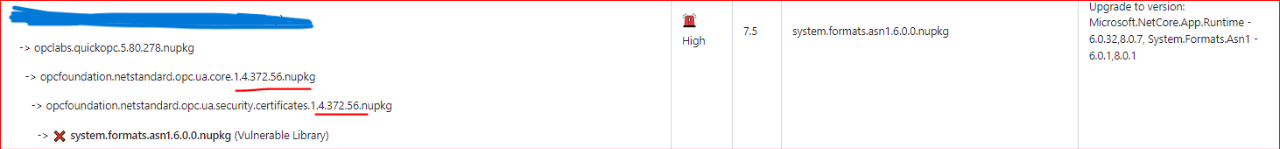

08 Aug 2024 06:44 #13003 by support
Effective with version 5.80.323.1, we have updated the QuickOPC and Excel products to reference OpcFoundation.NetStandard.* packages version 1.5.374.78, which resolves the vulnerability.

26 Jul 2024 16:48 #12976 by HelenPacheco
I was using OPCFoundation.NetStandard.Opc.Ua.Core, Version="1.4.371.96" and OpcLabs.QuickOpc Version="5.71.302on that OPC Labs version, OPC foundation could updated and was working properly, but for a change needed on my app, I had to update OPC labs to the recently version that has OPCFoundation already added, but it is a very old version with vulnerabilities, If I try to upgrade the OPC foundation, my app compiles, but once it is executing the it can assembly the bindings with the latest version, due the old version added into OPC Labs. New version with vulnerabilities:OPCLabs 5.80.278
