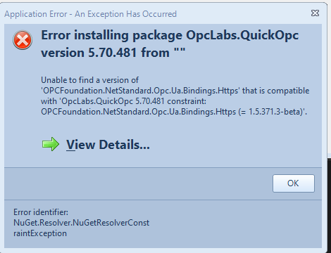

18 Dec 2022 13:32 #11350 by support
I was now able to make it a true fix, one that will not require the user to do any additional steps. I.e., both "packages.config" and "PackageReference" format should now work.
The fix is in build 5.70.507.1, released today. I will email you with further information for its distribution.

15 Dec 2022 14:50 #11345 by support
Thank you for the additional info. I was able to reproduce the problem.
Here is how to resolve it:
1. Visual Studio: Tools -> Options -> NuGet Package Manager -> General: Set "Default package management format" from "Packages.config" to "PackageReference".
2. If your project already references some NuGet packages, right-click on the project's Reference node in the Solution Explorer, and select "Migrate packages.config to PackageReference".
3. Repeat the actions you wanted to do originally.
I will investigate further why this is happening. I am not sure if it will be possible to fix it; if not, we will instead document that the "PackageReference" format is a requirement (and improve the error message to hint properly).

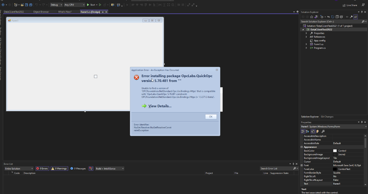

14 Dec 2022 13:06 #11342 by ZParham
Yes, I have an internet connection and am able to access nuget.org from a browser on my machine.
I had set up a separate file-based source just to double-check myself, as the error is occurring when not doing so as well.
Thank you very much!

13 Dec 2022 21:17 #11338 by ZParham
Apologies for my lack of clarity.
Below is a link to a video with some examples of the behavior, and steps taken. I am sure we are simply missing a step. Please let me know if you have any further questions or if the video does not work!
softwaretoolbox.sharefile.com/d-s77ff78b15991483a8579435daea39d95
As for the .NET 6.0 warning, it was not with a Windows Form. However, I am not certain that it is connected, and am happy to loop back around to it once we solve the primary issue we are seeing here.
12 Dec 2022 15:20 #11323 by support
It is not clear to me which action triggers the error: What do you mean precisely by "attempts to add any OPC Data Client feature to the form"? Please try to describe it in detail and step by step, it is important.
Also, it looks like you have not attached the screenshot with .NET 6.0 warning. But, we do not support Windows Forms controls/dialogs under .NET 6.0 yet. Only under .NET Framework.
12 Dec 2022 14:38 #11322 by ZParham
Hello!
A customer of ours is using 2022.2 (5.70).
He is creating a Windows Form (.NET Framework 4.7.2) in Visual Studio 2022 Enterprise on Windows 11 Pro 22H2.
When he goes to create a new project, and attempts to add any OPC Data Client feature to the form, he receives the error shown in the attached screenshot "NET_Framework_Error," with the full details of the error given at the end of this post.
We were able to recreate this behavior on Windows 10, and with .NET Framework 4.8 and .NET Framework 4.8.1.
We also tried this with .NET 6.0. It does not see the same behavior. However, it gives us the warning in the attached screenshot "NET_6_0_Warnings." Is this expected, or is there something we are missing?
Thank you in advance!
Zachary Parham
Exception Details: Error installing package OpcLabs.QuickOpc version 5.70.481 from ""
Type: System.InvalidOperationException
HResult: -2146233079 (0x80131509)
NuGet.Resolver.NuGetResolverConstraintException: Unable to find a version of 'OPCFoundation.NetStandard.Opc.Ua.Bindings.Https' that is compatible with 'OpcLabs.QuickOpc 5.70.481 constraint: OPCFoundation.NetStandard.Opc.Ua.Bindings.Https (= 1.5.371.3-beta)'.
at NuGet.Resolver.PackageResolver.Resolve(PackageResolverContext context, CancellationToken token)
at NuGet.PackageManagement.NuGetPackageManager.<PreviewInstallPackageAsync>d__76.MoveNext()
Message: Unable to find a version of 'OPCFoundation.NetStandard.Opc.Ua.Bindings.Https' that is compatible with 'OpcLabs.QuickOpc 5.70.481 constraint: OPCFoundation.NetStandard.Opc.Ua.Bindings.Https (= 1.5.371.3-beta)'.
