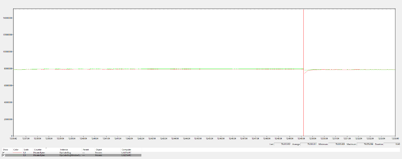

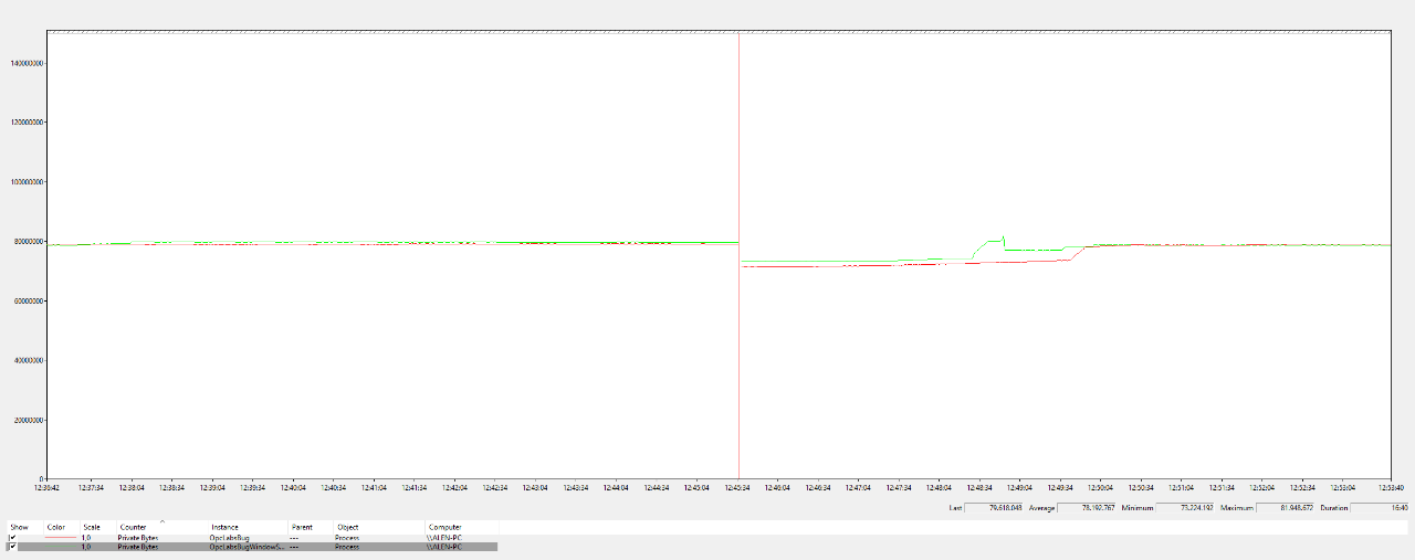

We started our application on 18.11 at 18:26 and its memory climbed from 57,9 Mb to 89Mb.
On monday 21.11 we started test console application provided in first github repo but with [MTAThread] attribute whose memory also raised with same speed as our appliaction.
We are connected to Prosys OPC UA simulation server and are only subscribed to events. We are receiving one event approximately every 20 seconds.
Everything is running on a virtual machine with more then enough memory and processing power using Windows Server 2022 Standard.
We are attaching images of almost 48 hours period, each image has date and time when it was taken in its name. Red line is our application which is using a bit more memory because it was started 3 days before and is much bigger by itself. The green line is test console application with just client and subscription.
We are continuing the test further and will reply with additional data within few days. We are posting this in hope of finding the solution sooner. If you have any idea to what could be the problem any advice is welcome. We don't think that after stopping any communication between client and server the memory consumption should stay the same. And that in normal conditions with only events where one event happens every 20 seconds our memory consumption rises for approximately 0.25Mb an hour for 5 days with no signs of falling.
21 Nov 2022 12:46 #11222 by support
I am sorry but again, the charts cannot be used to draw a conclusion. Their range goes to maximum of tens of minutes.
I need to see the chart at least 36 hours long, ideally longer.
Regards.

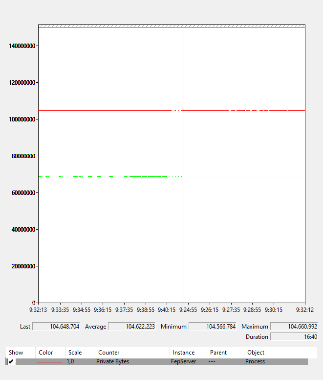

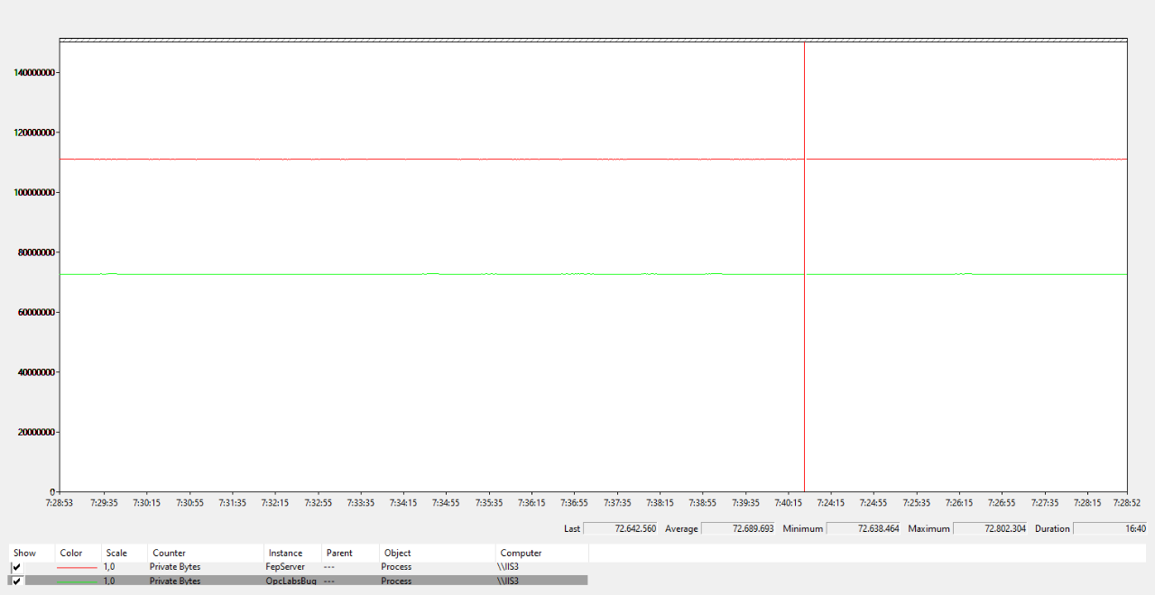

Here we have 2 application running, one is console application and the other is windows service app, both are just subscribed to events events no processing. Red one is console app and the green one is service.
-At 12:21:25 we started sending events
-At 12:25:35 we stopped sending events
-At 12:30:05 we started sending events again
-At 12:33:35 we stopped sending events
Images IMG1, IMG2 and IMG3 are showing memory in this situation.

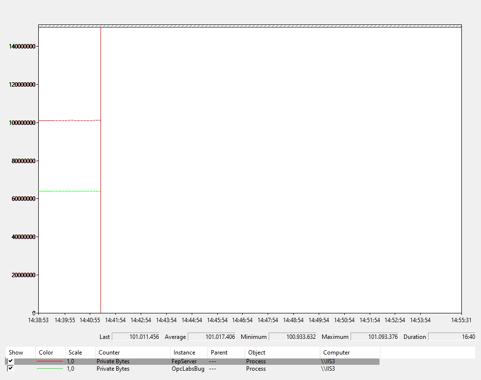

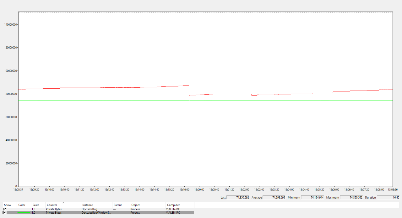

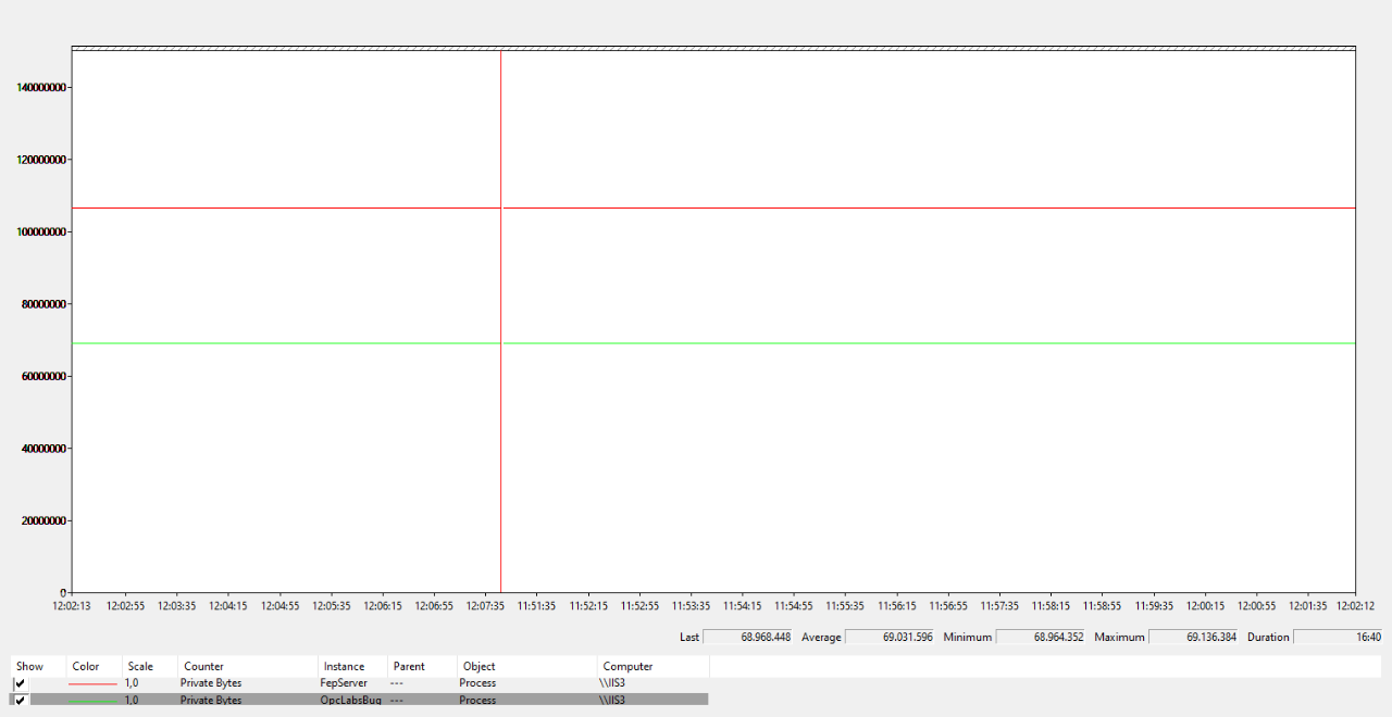

Images IMG4, IMG5, IMG6 are showing situation where there were no changes to console application but in windows service app we implemented timer which will be called every 5 minutes and it will call this code
if ( client != null ) { client.UnsubscribeAllMonitoredItems(); client.Dispose(); client = null; } Thread.Sleep( 1000 ); GC.Collect( GC.MaxGeneration, GCCollectionMode.Forced ); subscribe(); //Create new client and SubscribeEvent
