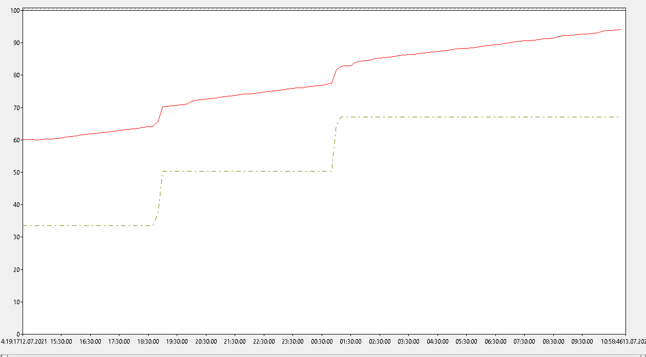

13 Jul 2021 09:49 - 13 Jul 2021 09:52 #9975 by zaglerp
we are experiencing an increasing memory usage of a process that uses QuickOPC and performs continous logging.
I have enclosed a sample program which creates an instance of EasyUaClient and starts logging into the file system.
There is no more OPC communication active, just creating the instance is enough to observe the increasing memory.
When running our OPC Client we see a constant increase in private bytes. After about 2-4 weeks of uptime the process is killed by the operating system, because the system runs out of memory.
The output of "Performance Monitor" for a short observation period of 16h is enclosed: red line = Number of private bytes of process; dotted line = Number of .NET CLR bytes
